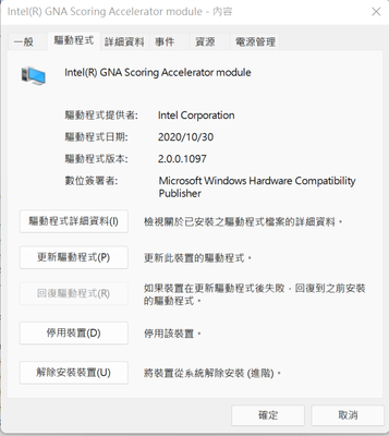

The reason of error for your both test is that you may use hardware GNA3.0 to infer NN1 & NN2.
NN1 & NN2's filter number (36684 & 9216)  are not up to the  GNA3.0 specifiaction (filter number <8192).
#{CPU & GNA information}
#{IR information: } precision is float 32
#{GNA3.0 spec}

Hi Zulkifli,
I can duplicate the error when I use another computer with CPU (12th Gen Intel(R) Core(TM)) i7-12700H).
I use the same virtual environment (openvino 2021.4) to run the script and get the same error message .
Finally, i use virtual environment (openvino 2022.1) to regenerate IR & infer scripts ,
and the script (NN2_CNN1D_GNA2.0Infer_NotWork.py) works.
So I update the attaced package (IR was complied from openvino 2022.1).

 Hello tea6329714,
Thank you for your patience,
We verified all of your tests and we would like to inform you that the GNA 3.0 limitations that you found are correct.
Thank you for asking this question, we'll update the documentation once we received the approval from the developer side.
