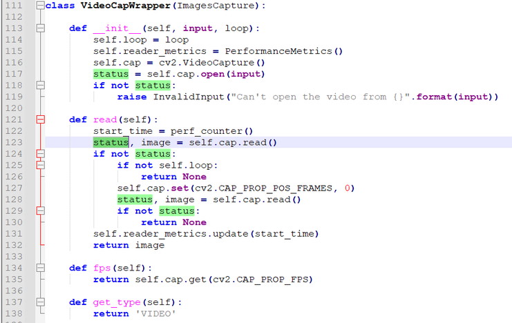

Hi, I am trying to convert the frame into grayscale by using the open_images_capture function. There has an error when the frame is converting into grayscale. The figure below shows the error message.
Is there any solution to solve it?

Hi Lc00,
Based on the limited information shared from your code snippet, I was not able to fully comprehend how your demo is running. However, you did mention that it works if you use cv2.VideoCapture instead of the open_images_capture function.
For your information, the open_images_capture function is somewhat similar to the workaround code I shared previously. The difference is that the open_images_capture function does not return the status value which is needed to check whether the frame is available to be loaded before the cvtColor function.
Here is the code snippet from open_images_capture as an example:
I would suggest you try these possible methods:
  1. Call your cvtColor function after the if not status inside of the open_images_capture function.
  2. Return the status value to your function and use the previous workaround code.

I have already tried the code you have given is working but when I replace the cv2.VideoCapture with open_images_capture function which existing in omz/demos/common/python there have errors like the picture shown above. Below is my code.

Hi Lc00,

Thank you. The problem already sloved.
