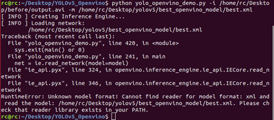

Hi, I am currently running Yolov5 with Openvino 2021.4 on my Ubuntu 18.04. I converted the best.onnx into best.xml using
$ cd /opt/intel/openvino_2021.4.582/deployment_tools/model_optimizer
$ mo --input_model /home/rc/Desktop/yolov5/best.onnx --output_dir /home/rc/Desktop
The best.xml is in IR 11 format. After that, I facing RuntimeError related to the reading of xml format as captured below:
The yolo_openvino_demo.py file I am running is obtained from https://github.com/bethusaisampath/YOLOs_OpenVINO/tree/main/YOLOv5
Anyone has ideas to solve this issue? Thank you very much.
Hi Bendan,
For your information, the error, "Unknown model format! Cannot find reader for model format" means that the IR-version is not supported.
In short words, OpenVINO™ 2022 is able to load IRv10 (converted by Model Optimizer 2021.4) and IRv11 (converted by Model Optimizer 2022.1) into Inference Engine whereas OpenVINO™ 2021.4 is only able to load IRv10 and will produce the above error if loading IRv11.
Your generated IR is in version 11 which I believe you used OpenVINO™ Model Optimizer 2022 to convert the ONNX model to IR, as I noticed you used the Model Optimizer command, mo --input_model best.onnx.
I would suggest you re-convert your ONNX model to IR with OpenVINO™ Model Optimizer 2021. Please make sure the generated IR is in version 10.

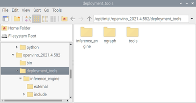

Hi Peh,
Thank you for the information provided! I already done your Step 1, and facing some issues when doing Step 2. As you can see in the figure below, there is no model_optimizer folder in opt/intel/openvino_2021.4.582/deployment_tools/. May I know how can I install the model_optimizer properly? Because previously I tried to install, but seems the installation failed.
Thank you very much!

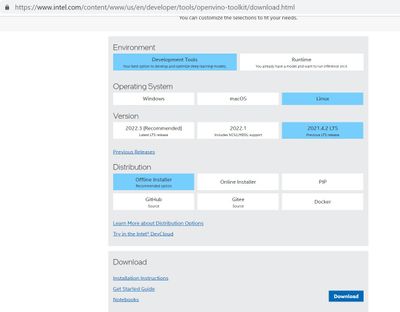

Hi Bendan,
In this case, please re-download and install OpenVINO™ 2021.4.752.
Download link:
https://www.intel.com/content/www/us/en/developer/tools/openvino-toolkit/download.html
During the installation, please make sure Model Optimizer is included in the installation summary and the installation is success.

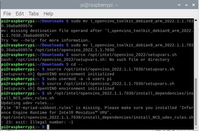

Hi Peh,
Now I want to install Openvino 2022.1.1 on my Raspberry Pi 4. I downloaded the l_openvino_toolkit_debian9_arm_2022.1.1.7030.39aba80957e.tgz from https://storage.openvinotoolkit.org/repositories/openvino/packages/2022.1.1/ .
After that, I followed the step on https://docs.openvino.ai/2022.1/openvino_docs_install_guides_installing_openvino_raspbian.html# . However, when I followed the step in https://docs.openvino.ai/2022.1/openvino_docs_install_guides_configurations_for_ncs2.html#ncs-guide-raspbianos to configure NCS2, I facing error as shown in figure below.
Do you have any idea on this?
Thank you.
Hi Bendan,
The issue has been fixed in OpenVINO™ 2022.2.
Please install OpenVINO™ 2022.2 for Raspbian OS and refer to Configurations for Intel® Neural Compute Stick 2.
Wan
Hi Wan,
I installed Openvino 2022.2 by following exactly install_guides_installing_openvino_raspbian but still facing the same error when configuring NCS2.
Thank you.

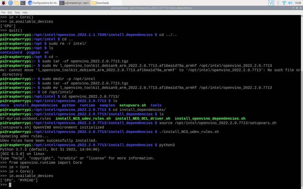

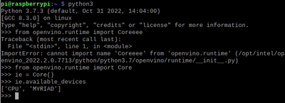

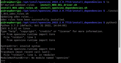

Hi Wan,
Yes, 97-myriad-usbboot.rules exists. However, when I tried to check device using from openvino.runtime import Core, the error stated there no module named "openvino". I already initialized the Openvino environment before that.
Thank you.
Hi Bendan,
Thanks for your information.
Please follow the steps below and see if the issue can be resolved:
- Close current Terminal
- Set the Environment Variables again
source /opt/intel/openvino_2022/setupvars.sh
Wan
Hi Wan,
After I get this result, it means the NCS2 was configured on my Raspberry Pi 4, right?
Thank you.
Hi Bendan,
Yes.
Wan
