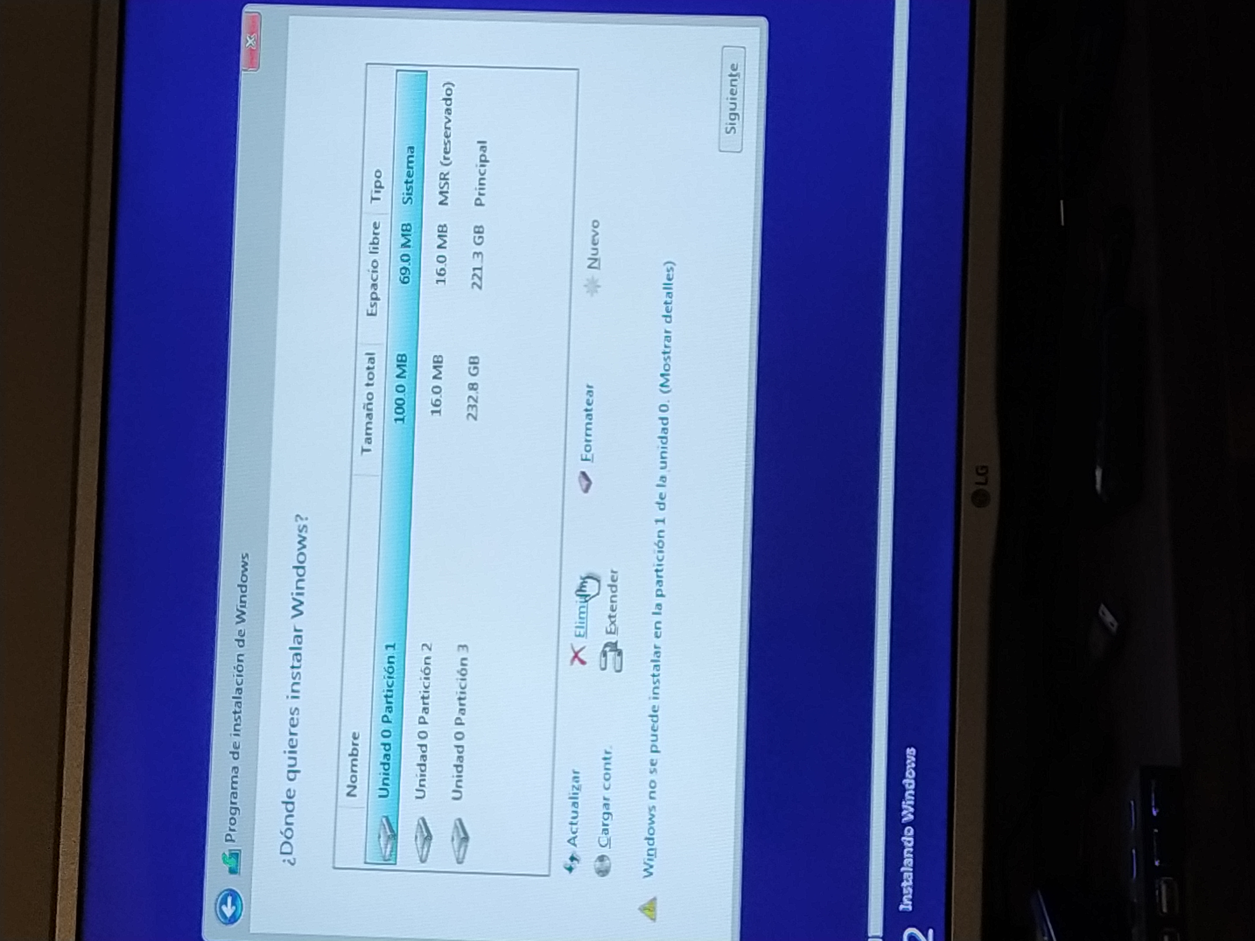

So I did as you and Scott recommended, same results, I reach to the screen that says "Where do you want to install Windows?" (see 1.jpg).
If I hit "Next", it says I don't have enough space. If I hit "Refresh" the only item from the list disappears (see 2.jpg).

When you reach the place "Where do you want to install Windows?", select your drive and then click on Delete. Once you see one Unallocated space, click on Next.

I can´t click on Delete because that option is greyed out:

One thing more: If you receive a "Windows can't be installed on drive 0" warning, you will still be able to as long as you can click/tap on the Next button. Windows Setup will automatically create the 4 partitions below on the drive, and install Windows 10 on the primary partition.

2. Manually copy the driver to the root of the flash drive. When I did this, VOILA the disk FINALLY appears in the Windows installer assistant! I even deleted the partitions from cmd (shift+F10 and then the commands from disk part). However after the assistant finishes the installation and reboots, the machine would freeze
