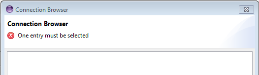

Since updating to SoC EDS 15.0.1, I am no longer able to connect to my SoCKit over USB. In DS-5 (Eclipse), here is what I am doing:
1. Run > Debug Configurations
2. Under DS-5 Debugger on the left, choose "Altera-Cyclone-V-(Single_Core)_RAM
3. On the Connection tab, choose Altera > Cyclone V SoC (Single Core) > Bare Metal Debug > Debug Cortex-A9_0
4. Target Connection = USB-Blaster
5. Under Connections, click Browse.
Connection Browser says "The script file (device_browser.py) failed during execution.
As far as I remember, Device Manager looks just like it did when I had this working.
In Device Manager, under JTAG cables, it shows the following:Altera USB-Blaster II (JTAG interface)
Altera USB-Blaster II (System Console interface)
Under Ports (COM & LPT), it shows:Communications Port (COM1)
USB Serial Port (COM3)
I have tried disabling the drivers then enabling, uninstalling the drivers then re-installing, powering the board on and off, restarting Eclipse.
Any suggestions appreciated.
Ron
9 Replies
Altera_Forum
1,082 Views
Using “Debug Hardware Firmware Installer” view, I found another way to open the Connection Browser and it does not show any devices (should show SoCkit), so I don’t believe there is any problem with the script file. I also tried restarting the PC.
Ron
https://www.alteraforum.com/forum/attachment.php?attachmentid=11060

I noticed that is you hover over the message "The script file (device_browser.py) failed during execution, another message pops up: "The script file (device_browser.py) failed during execution:
Error: Failed to load client llibrary jtag_client.dll. Please ensure that the environment variable QUARTUS_ROOTDIR is set to the path to the Altera Quartus tools installation." I then noticed that this environment variable was set incorrectly. I corrected it, but that did not solve my problem.

My connection problem went away. It was not clear to me what happened to fix it. It may have been some jumper settings on my SoCkit.

the problem seems to be related with glibc incompatibility.
look for errors when starting ds-5 in commandline.
following this http://gilleslasnier.com/blog/2016/09/10/altera-quartus-15_1-failed-to-load-libraries/ resolves this
