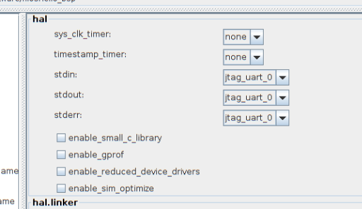

Hi
You could add in the UART IP and select the UART IP in the BSP generation when selecting the source of printout.
Jingyang, Teh
