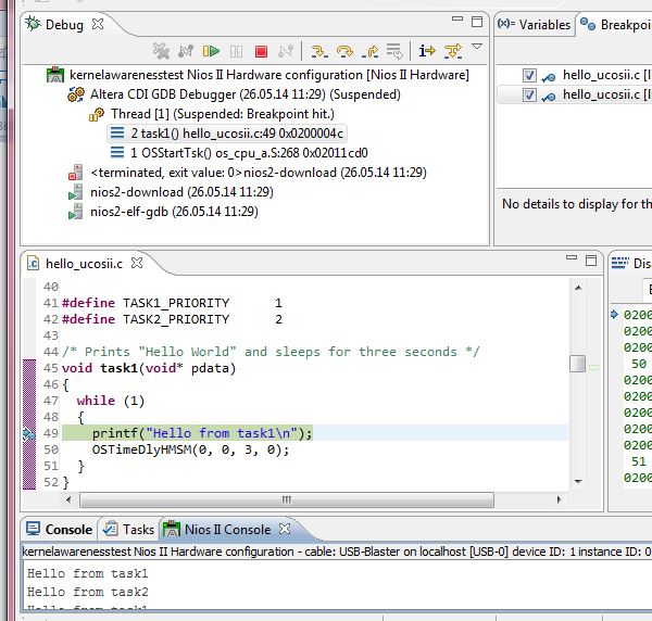

I am migrationg my NIOS2-Project with µCos/II from Quartus 9.1sp2 to Quartus 13.1.
To debug my software I used the old IDE, because the SBT-Environment could show only one stack (the one of the current running task). The IDE showed all the stacks of all tasks.
Now, I hoped the new Debugger finally has the kernel-awareness again, but I still see only one stack.
To reproduce my issue, you can use the hello_ucosii-Project from Template.
n2sw_nii52008.pdf says: "When you debug a MicroC/OS-II application, the debugger can display the current state of all threads in the application, including backtraces and register values." But, the Debugger can't!
What do I wrong? Can anybody help me?
