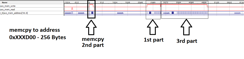

Custom slave which uses waitrequest and bursts. Memory map: 0x200000 - 0x3FFFFF.
I want to write 256 Bytes to the slave, it's a spi controller so the master (NIOS f) should write the data without doing anything in between, I want to check the status register in software.
Problem: When accessing 0xXXXD00 and 0XXXF00 with memcpy I get the following (doesn't matter if 0xXX1D00, 0xXX2D00 and so on):
I use the following code to write to the slave (Avalon slave):
memcpy((alt_u8*)(mem_base+addr),(alt_u8*)(src_cached_ptr),length); alt_dcache_flush_all();
avs_mem_xxx is the signal from the master to the slave after the interconnect component. The system is generated in the Platform Designer.
0xD00:
The write is splitted into 3 parts: 1st part and 3rd part happens when I use flush, the 2nd part is written while executing memcpy.

What I understood that you have two questions (correct me if I am wrong). First the memcpy works fine with all addresses but the 0XF00, plus you want to keep the memcpy moving data without interruption.
For the first question I will try to replicate this issue on a board I have and see why this happens.
For the second, I advise you to use the MSGDMA or any DMA IP (MM to MM). This will solve your problems and give the targeted results.

Yes I want to make memcpy without any interrupt. I haven't tried to see if signaltap or the debug component in the NIOS is causing the interrupts, but I made auto write enable to solve my problem, but if I reactivate this project, I will try the DMA solution and look if debugging components caused the interrupts.
