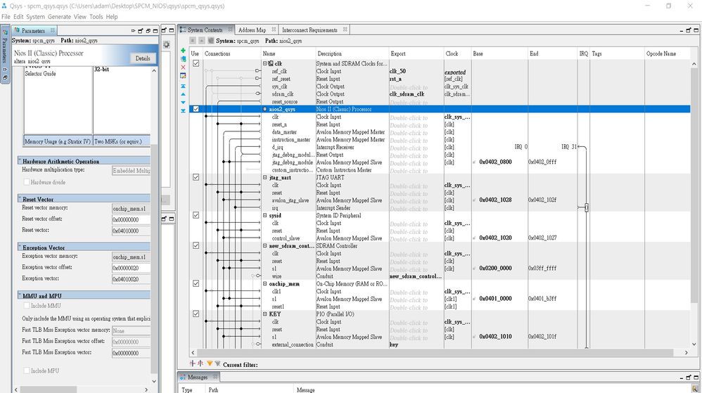

I want to write data to sdram via nios2, then read data out and connect to LEDs to see if the data is correct.
Below is my code and results.
In the code I add printf("isr\n") to make sure interrupt is in effect.
Before "return 0" in the main(), I add printf("b\n") to check if the program is executed outside of while(1) loop, which is not allowed.
But when I write to the 65th date, the program is stuck,
and the interrupt is not working also.
I don't know what happened,
could anyone help me?
thanks a lot!
2019/3/21 update:
I attach my fpga file,
for .elf file please use SPCM2.
#include <stdio.h> #include <unistd.h> #include "system.h" #include "alt_types.h" #include "io.h" #include "altera_avalon_pio_regs.h" #include "sys/alt_irq.h"   int bKeyPressed = 0; int cnt = 1; alt_u16 incre = 0; alt_u16 data, data0;   void KEY_ISR(void* context){ bKeyPressed = 1;   IOWR_ALTERA_AVALON_PIO_EDGE_CAP(KEY_BASE,0); printf("isr\n"); }   void EnableKeyInterrupt(void){ int error;   IOWR_ALTERA_AVALON_PIO_IRQ_MASK(KEY_BASE,0x03); IOWR_ALTERA_AVALON_PIO_EDGE_CAP(KEY_BASE,0);   bKeyPressed = 0; error = alt_irq_register (KEY_IRQ, 0, KEY_ISR); if (error) printf("Failed to register interrut\r\n"); }   int main() { EnableKeyInterrupt(); IOWR(LED_BASE, 0, (alt_u8)0);   while(1) { if(bKeyPressed) { bKeyPressed = 0;   *((alt_u8*)NEW_SDRAM_CONTROLLER_0_BASE + incre) = cnt; data = *((alt_u8*)NEW_SDRAM_CONTROLLER_0_BASE + incre);   printf("cnt = %d, ", cnt); printf("incre = %d, ", incre); printf("data=%d\n", data); IOWR(LED_BASE, 0, (alt_u8)data); cnt ++; incre += 1; } } printf("b\n"); return 0; }isr cnt = 1, incre = 0, data=1 isr cnt = 2, incre = 1, data=2 isr cnt = 3, incre = 2, data=3 isr cnt = 4, incre = 3, data=4 isr cnt = 5, incre = 4, data=5 isr cnt = 6, incre = 5, data=6 . . . . isr cnt = 65, incre = 64, data=65

Without your Qsys / Platform Designer code it is not easy to help you.
But based on what I see, there is no limit to the value that "incre" can have.
Therefore sooner or later you risk to write beyond the limits of the dedicated memory.
Also it is very well possible that you are writing into the zones that are used for other purposes hence making your system unstable.
Johi.

my qsys and top level are as below,
I use the onchip memory as nios2 cpu's memory.
Yes, it's very likely that data is written into the zone that is for other purpose,
is there any way to avoid it?
adam
