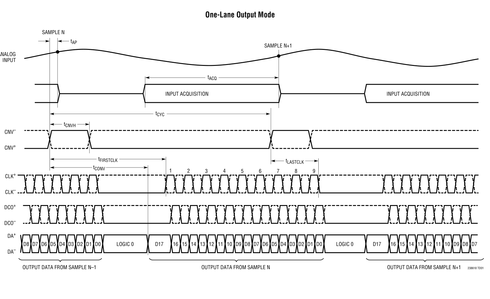

I need LVDS deserialising logic for the LTC2386-18 ADC and before trying to code it up myself I was wondering if there's already any VHDL out there that I could try-use. It doesn't look like rocket science but I'm no VHDL wiz and I don't have any hardware yet and it would de-risk the project if I can do a trial fit and palce my IO.
I've attached the data sheet.
did you notice that LTC2386 demo board uses a Cyclone 3 FPGA and comes with example code?

Frank, that's just the sort of answer I was hoping for!
I'll look for that resource and see about dropping it into my design.
Many thanks, Oliver
Please check LTC2386 demo board resource, you can find the code example in the board resource.
