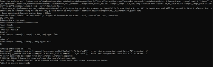

Thanks we are able to accelerate NPU now, but when trying to run model with batch size 2 on NPU it fails. The mode is static still it fails for batch 2 or any other batch except 1 and below is the error.

Good to hear that you are able to accelerate the NPU now. I noticed you have submitted the same issue in the thread below:
https://community.intel.com/t5/Intel-Distribution-of-OpenVINO/Cannot-run-Stable-Diffusion-model-on-NPU/m-p/1571447#M30674
I will close this ticket and we will continue providing support on that thread. This thread will no longer be monitored since this issue has been resolved. If you need any additional information from Intel, please submit a new question.
