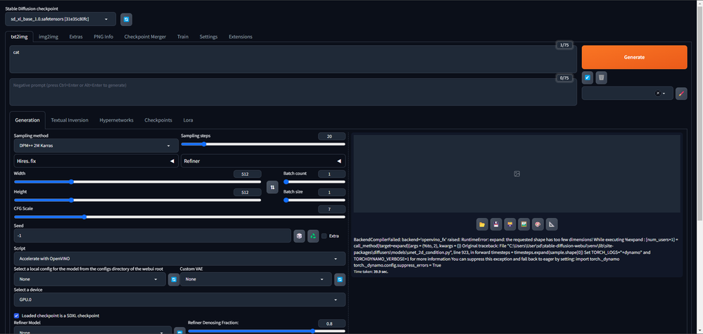

I got stable diffusion working on my A770 and I want to upgrade to sdxl. I downloaded an sdxl model and loaded it, and it ran but had weird colors. I thought I just need a vae. I download the vae, change the vae setting, and when I hit generate I get the error:
BackendCompilerFailed: backend='openvino_fx' raised: RuntimeError: expand: the requested shape has too few dimensions! While executing %expand : [num_users=1] = call_method[target=expand](args = (%to, 2), kwargs = {}) Original traceback: File "C:\Users\corey\AppData\Local\Programs\Python\Python310\stable-diffusion-webui\venv\lib\site-packages\diffusers\models\unet_2d_condition.py", line 923, in forward timesteps = timesteps.expand(sample.shape[0]) Set TORCH_LOGS="+dynamo" and TORCHDYNAMO_VERBOSE=1 for more information You can suppress this exception and fall back to eager by setting: import torch._dynamo torch._dynamo.config.suppress_errors = True
I went back and removed the vae from the folder and changed the settings back to what they were, and I'm still getting the same error. I can't even get the weird color image I had before. When I originally clicked "apply settings" after adding the vae, it said about 30 things had changed. When I clicked that button to undo the vae, it said only one setting had changed. My best guess is one of those random changes is causing the error, but I have no idea which one it could be out of the hundreds of settings.
I deleted my config.json file and restarted a1111 to reset my settings. I get the exact same error from above. I went back and hit apply settings again just to get the list in case this helps you. I think it was 29 changes the first time but I didn't modify the vae settings again:
27 settings changed: ldsr_steps, ldsr_cached, SCUNET_tile, SCUNET_tile_overlap, SWIN_tile, SWIN_tile_overlap, lora_functional, sd_lora, lora_preferred_name, lora_add_hashes_to_infotext, lora_show_all, lora_hide_unknown_for_versions, lora_in_memory_limit, extra_options_txt2img, extra_options_img2img, extra_options_cols, extra_options_accordion, canvas_hotkey_zoom, canvas_hotkey_adjust, canvas_hotkey_move, canvas_hotkey_fullscreen, canvas_hotkey_reset, canvas_hotkey_overlap, canvas_show_tooltip, canvas_auto_expand, canvas_blur_prompt, canvas_disabled_functions.
Of course I would prefer not to reinstall everything. If I did that and got back to the same point, how would I even use the vae without running into the same error again? Also, I notice I can run the sdxl model without openvino on the cpu, and it runs fine with normal colors even without the sdxl vae.

For your information, I downloaded the stable-diffusion-xl-base-1.0 model and was able to generate an image on the first try. However, I received the same error as yours on my subsequent tries. webui-error .png
On the other hand, generating images without selecting the "Accelerate with OpenVINO" script works just fine as you mentioned.
I tried downloading another model (anything-v3.0) and was able to generate images with the OpenVINO™ script selected multiple times without encountering any error messages. anything-v3 .png
The error might be due to model incompatibility with OpenVINO™. Can you confirm with us the exact sdxl model and the vae model link that you used for us to investigate further?
