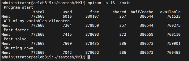

I tried to reproduce your issue from my end and below are my observations:

Intel MPI + MKL :
Steps:
  1.  source /opt/intel/oneapi/mpi/latest/env/vars.sh
  2.  source /opt/intel/oneapi/compiler/latest/env/vars.sh
  3.  mpiifort -c working_ex.f90 -o bin/working_ex.o
  4.  mpiifort -O0 -g -debug -qmkl=cluster -recursive bin/working_ex.o -L${MKLROOT}/lib/intel64 -lmkl_scalapack_ilp64 -lmkl_intel_ilp64 -lmkl_intel_thread -lmkl_core -lmkl_blacs_intelmpi_ilp64 -liomp5 -lpthread -lm -ldl -o main
  5. mpirun -n 16 ./main
Observations:
Could you please let me know if there is anything that I missed or went wrong while trying the OpenMPI+MKL combination?
Santosh
