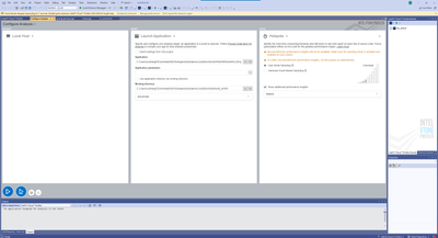

Follow your latest email I have done the following:
-Start with a new fresh installation of W10 X64 bit
-Installed Visual studio 2022 v17.7.5 without SDK
-install One API latest version
-Install Fortran latest version
When compiling project I get the error in fig1. and compilation fails
-Added w10 SDK
-compilation is successful but both Vtune and Intel advisor don't work getting error fig2 and fig. 3
Can you provide a specific version and specific step so I can have everything working ?
I kind feel we going in to some infinite loop here, for instance I am hoping to have visual studio 2022 (any version I don't care which one as long work) with latest OneAPI and Fortran compiler everything working eg vtune and advisor
Thank you
yuzhang3_intel
1,846 Views
From the steps you listed, it looks it is correct, you can see the integrated VTune works in my local VS 2022 v17.7.2 with the same installation steps.  If you launch VTune directly rather than from VS, it can work?
