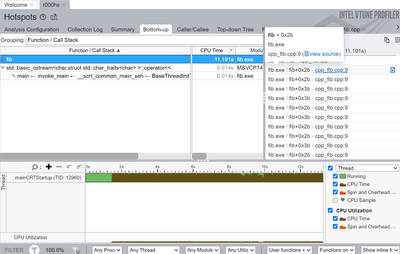

We took a small C++ sample where main function calls another function fib() from another program file(cpp_fib.cpp). Let me explain in detail as follows:
  • In the Summary Window of Vtune Profiler, I clicked on fib function, which is highlighted, from the below screenshot and got navigated to the Bottom-up window.
  • In the bottom-up window, if you double click on any function/call stack in the left sided pane, you could see the source code. We double clicked on fib to see fib.cpp program's source code as follows:
Note: The above screenshot only has 0.1% as it takes some negligible amount of time to print the result from fib(n) function. So, to see the Total CPU time that the fib(n) took, including calling and executing, you need to view source code from the Call stacks pane. See the detailed explanation with screenshots as follows.
  • In the bottom-up window, there’s a Call Stacks pane where you could hover over the .cpp files and you can view the source code of the functions you’ve called. The main() function in fib.cpp program is calling another function fib() which exists in cpp_fib.cpp program.
  • By clicking on view source from the pop as shown above, You would be navigated to the cpp_fib.cpp source code where you could see the CPU time as follows:
  • You could go back to the bottom-up pane to get any source code by hovering over each file in the Call Stacks Pane as follows:
Hope we are clear with all the details and result interpretations. If this resolves your issue, please accept this as a solution. This helps others with similar issue. Thank you!
