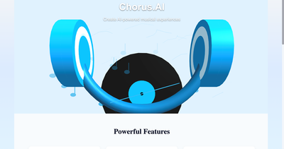

Figure 1 and Figure 2 below show how the UI of the project looks like.
Fig.1: UI of Chorus.AI
Fig.2: UI of Chorus.AI
