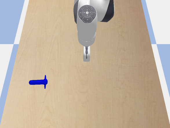

What’s our goal?
Robots can be trained using a simulation, which is more cost-effective and faster than using a real robot arm. For our research, we created a simulated robot environment with PyBullet.
Our goal is for the robot arm to learn to move towards the object on its workspace and then to hover over it (see Figure 2). This is the kind of task a robot arm might need to perform when carrying out repairs or assembly work.
The approach we describe here could also be used for deep reinforcement learning of other control problems, including video games.
Figure 1: Our robot simulationFigure 1: Our robot simulation

We used the Stable Baselines 3 library of PyTorch reinforcement learning algorithms to train our robot arm simulation. Using SAC as our algorithm, we can solve our task in under 8000 steps. Figure 3 shows the training in action.
When training, the library prints out some metrics to let the user know how the training is progressing. The most important metric is the ep_rew_mean which quantifies how much reward the robot arm is accumulating. If this number continues to increase, then the robot is learning, and the algorithm is working.
Figure 2: This animated GIF shows the robot in the training phase. The robot is exploring the state-space while getting feedback from our reward classifier network on whether the goal has been achieved or not.Figure 2: This animated GIF shows the robot in the training phase. The robot is exploring the state-space while getting feedback from our reward classifier network on whether the goal has been achieved or not.
To see the impact of using the Intel Distribution of OpenVINO toolkit, we ran the workload twice: first using native PyTorch for our reward classifier inferencing, and then using OpenVINO.
The Intel Distribution of OpenVINO toolkit accelerated our deep reinforcement learning workload by approximately 12 percent on average.
