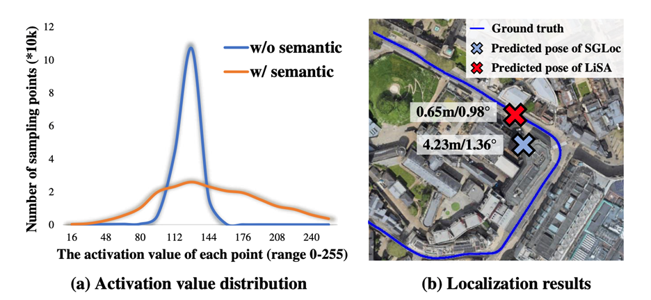

As shown below in Figure 7, LiSA’s activation distribution is less centralized, meaning the activations on a variety of objects are different, leading to a much higher localization in practice.
Figure 7. Activation value distributions and localization results of LiSA (with semantic) and SGLoc (without semantic). (a). Given a point cloud sampled from QEOxford, we first aggregate features in the regressor (before heads) and normalize their activation values into [0,255]. Without semantic awareness, most activation values of SGLoc are clustered in the center, indicating that almost all points are treated equally. (b). The localization accuracy with semantic awareness (LiSA) is much higher than the baseline (SGLoc) without semantic awareness.
