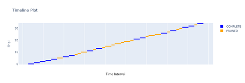

Then, we tune the learning rate and weight decay hyperparameters by using the Tree-structured Parzen Estimator (TPE) algorithm via Optuna, aiming to maximize the validation F1-score. Also, we use Optuna’s pruning callback to terminate underperforming hyperparameter trials. For more information on the hyperparameter search space, and the best performing hyperparameters, refer to the model card on Hugging Face.

Figure 2. Timeline plot of Optuna trials (0-34) showing trial progression over time, with completed and pruned trials distinguished.
