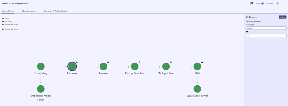

The Control Plane tab in Intel® AI for Enterprise RAG provides a clear view of the pipeline components that make up the Chat Q&A system. For a detailed overview of each component and its configuration options, see the Admin Panel documentation.
The reasoning path begins with the retriever processing the input query to identify relevant documents from the knowledge base. Inspecting the payloads and data flow for specific queries helps troubleshoot unanswered or unsatisfactory responses. To access this functionality, click the Retriever component to open its corresponding tab, and then select the Debug option in the top-right corner.
Figure_05_ERAG_Control_Plane.pngFigure 5. View of the Intel® AI for Enterprise RAG Admin Panel → Control Plane in debug mode. This view shows all pipeline components along with their statuses - green for operational and red for blocked. In debug mode, selecting the Retriever opens a right-side menu that provides access to the Debug interface, enabling interaction with the retriever and inspection of its data payload.

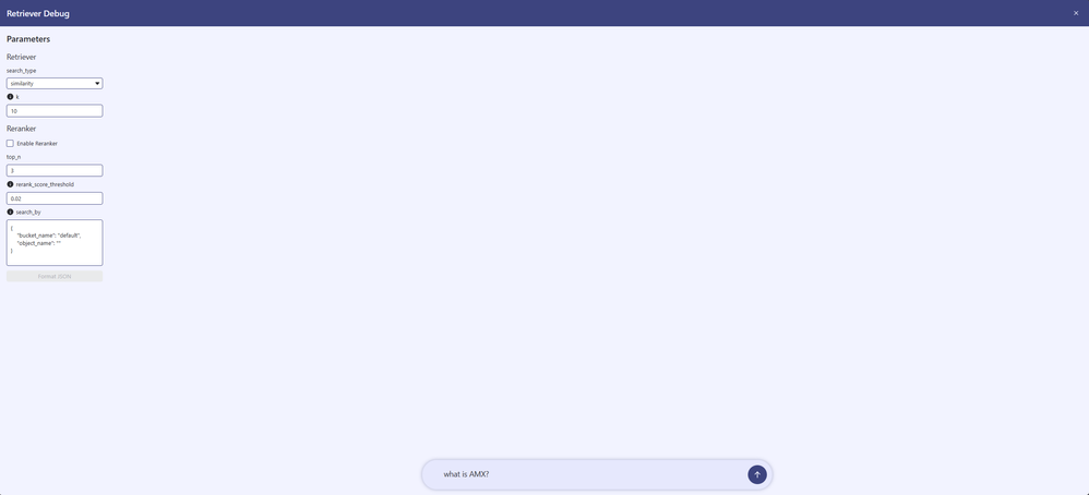

Opening Retriever → "Debug" launches a window to test how queries are processed in the Enterprise RAG pipeline. Let’s enter an example query, ‘What is AMX?’, to observe how the retriever selects relevant documents.
Figure_06_ERAG_Retriever_Debug_View.pngFigure 6. Retriever Debug allows entering a query to follow the retrieval path and inspect which documents are selected.

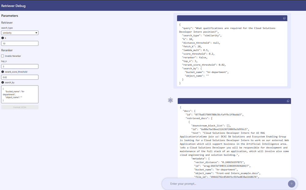

Intel® AI for Enterprise RAG provides Role-Based Access Control (RBAC), so system responses can vary depending on the user profile, which may have access only to specific documents. It is possible to simulate a user’s interaction with the RAG pipeline by restricting the search_by parameter to only the bucket or list of buckets that the user has access to. For example, testing with an hr-department bucket ensures the pipeline behaves as if accessed by an HR user, retrieving only authorized content.
Figure_09_ERAG_Retriever_Debug_Output_With_Search_By.pngFigure 9. Retriever Debug View with retrieval restricted to the hr-department bucket.

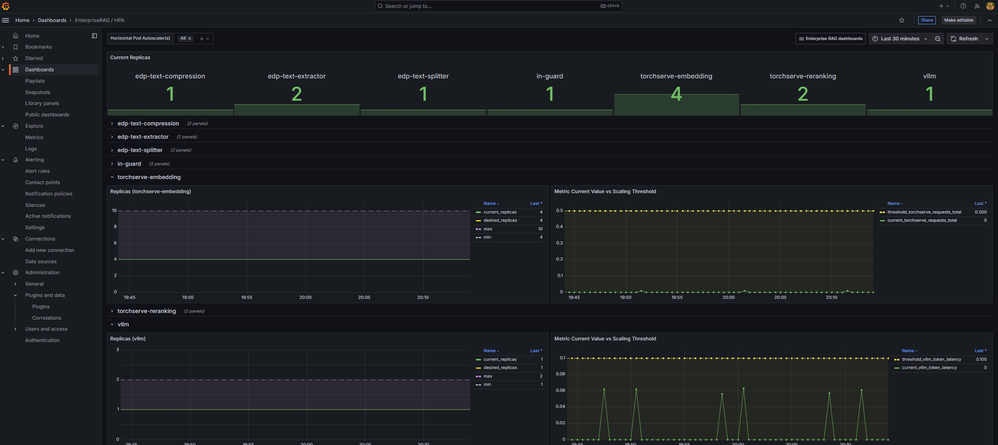

One of the dashboards continuously tracks Horizontal Pod Autoscaler (HPA) activity, highlighting how the Intel® AI for Enterprise RAG system responds to workload fluctuations and makes scaling decisions. To learn more about the HPA mechanism, please refer to the article "Deploying Scalable Enterprise RAG on Kubernetes".
Figure_10_ERAG_Telemetry_HPA_Dashboard.pngFigure 10. Grafana Dashboard for Horizontal Pod Autoscaler, showing real-time scaling activity, replica counts, and metrics used for automatic resource adjustment. Note: Values shown on the dashboard are illustrative for this deployment and are not indicative of any performance benchmarks.

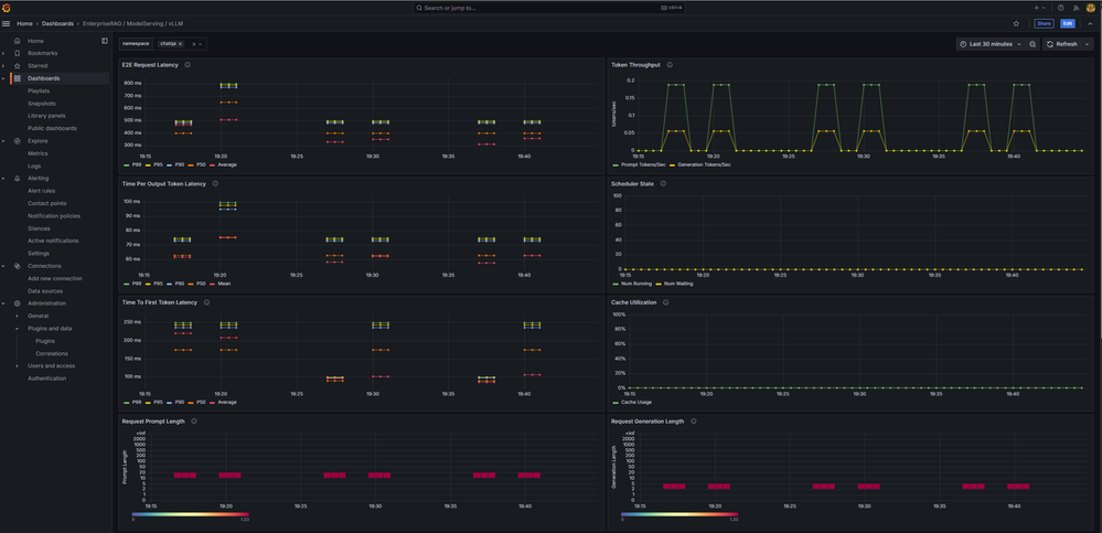

Additionally, there are dashboards displaying metrics for specific components in the RAG pipeline. For example, one such dashboard focuses on VLLM, a key component responsible for generating responses to user queries. It enables administrators to monitor how VLLM handles incoming requests, providing insights into token throughput, time per output token, time to first token, and other performance metrics. These metrics reveal how the selected Large Language Model (LLM) performs depending on the number of deployed replicas, underlying infrastructure, and configuration settings. Extended time to first token or spikes during high-traffic periods may indicate the need for deployment adjustments to ensure users receive timely responses and a smooth chat experience.
Figure_11_ERAG_Telemetry_VLLM_Dashboard.pngFigure 11. Grafana Dashboard for VLLM, showing key performance indicators for this component in the RAG pipeline. Note: Values shown on the dashboard are illustrative for this deployment and are not indicative of any performance benchmarks.
