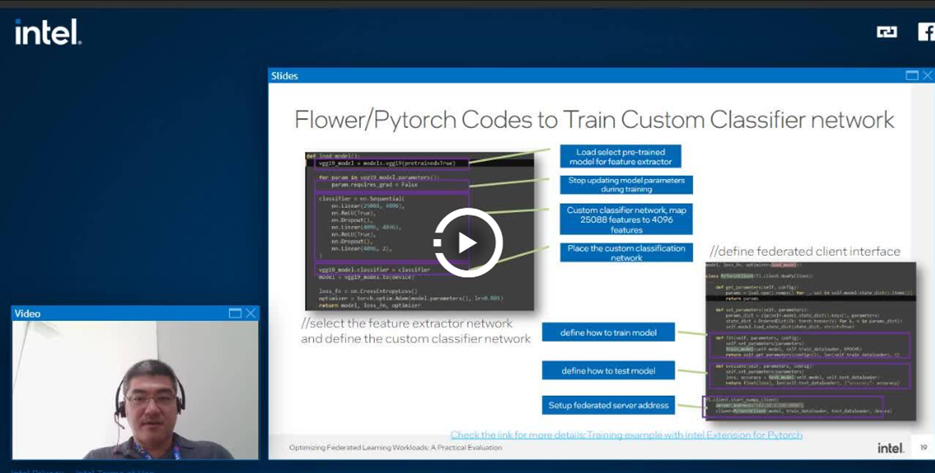

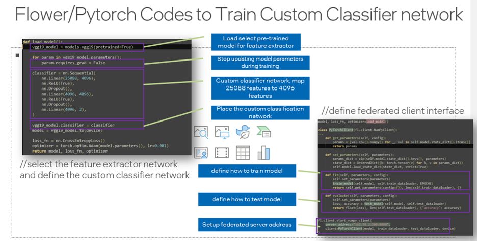

The federated learning framework used in this project is Flower, an open-source framework that simplifies the orchestration of federated training. Flower facilitates the exchange of model parameters between clients (local institutions) and the central server. The framework supports advanced aggregation techniques, such as weighted averaging, ensuring that institutions contributing more data have a proportionally larger impact on the final model.
Joel also demonstrates how the pre-trained VGG19 model is used as a feature extractor in the federated learning setup. By freezing the layers of this pre-trained model, the system focuses solely on training a custom classification layer that maps 25,088 extracted features to the final output classes. This technique leverages transfer learning to accelerate training and improve accuracy with limited data.
