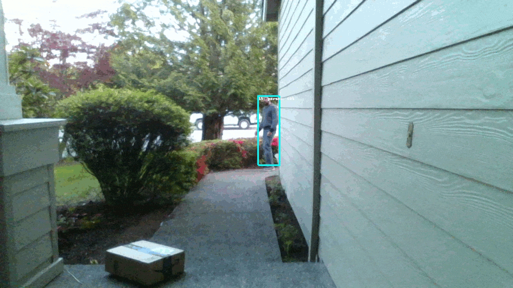

In order ensure that my proof of concept would work in real-world situations, I had to pick a network that not only runs fast on the Intel® Movidius™ Neural Compute Stick, but also has a ‘person’ category and is capable of dealing with multiple subjects or objects in a single image (or a single camera frame). Fortunately, MobileNet SSD meets all of these requirements, and a pre-trained model is readily available [3]. A quick test of running MobileNet SSD on the system yielded the following results..
Network Inference time Frames per second
MobileNet SSD 80.47414 ms 12.4 fps

The Neural Compute App Zoo [4] is loaded with example apps, so I leveraged an existing app called live-image-classifier as the foundation for this project. Apart from writing a utility script to de-serialize the output into a Python dictionary, I only had to update steps 3 and 4 to create a working prototype of the application.
Putting it all together
There was a small hitch while migrating the app from my development laptop to the OctoCam’s Raspberry Pi Zero W. The code relied heavily on OpenCV[7] to capture and preprocess frames from the camera, but there is no pre-compiled OpenCV binary or python wheel for the Raspberry Pi. On a Raspberry Pi 3 Model B, compiling OpenCV from source takes about 4 hours, but it failed after 56 painful hours on my RPi Zero W. I could have tried cross compiling on a development machine, but I decided to take a much more effective approach of using PiCamera [5] for capturing camera frames and PIL [6] for pre-processing images and visualizing the output.
Below is a video recording of my ‘DIY smart security camera’ in action. Although the MobileNet SSD model is capable of detecting twenty different classes, the code is designed to capture images (or record video snippets) when a person is detected. Since the RPi Zero has built-in WiFi, I can easily SSH into the device from my development laptop and tweak the trigger mechanism. For example, it only takes a 2-3 line code change in Step 4 to start recording only if both a dog and a person is detected.
Figure 6: This is me trying to steal a package from my own porch
NOTE: I had to change the trigger mechanism to ‘person + dog’ on my security cam, because I have an ongoing problem with someone not cleaning up after their dog.
