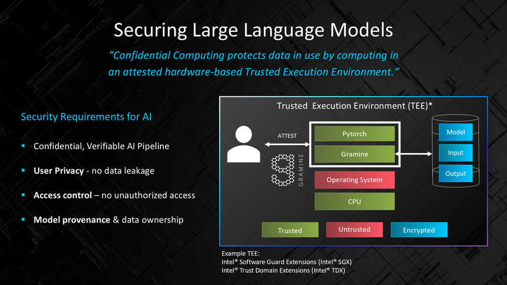

When inference execution is done in the company compute environment (client, edge, on-prem, or IaaS), there is a higher requirement for CapEx for ownership of the computer equipment if it goes beyond adding a workload to existing hardware. While the comparison of OpEx vs. CapEx is complex and depends on many variables, CapEx is preferable when deployment requires broad, continuous, stable usage. This is especially true as smaller models and optimization technologies allow for running advanced open source models on mainstream devices and processors and even local notebooks/desktops.
Running inference in the company compute environment allows for tighter control over aspects of security and privacy. Reducing data movement and exposure can be valuable in preserving privacy. Furthermore, a retrieval-based AI solution run in a local setting can be supported with fine controls to address potential privacy concerns by giving user-controlled access to information. Security is frequently mentioned as one of the top concerns of companies deploying GenAI and confidential computing is a primary ask. Confidential computing protects data in use by computing in an attested hardware-based Trusted Execution Environment (TEE).
Smaller, open source models can run within a company’s most secure application setting. For example, a model running on Xeon can be fully executed within a TEE with limited overhead. As shown in Figure 8, encrypted data remains protected while not in compute. The model is checked for provenance and integrity to protect against tampering. The actual execution is protected from any breach, including by the operating system or other applications, preventing viewing or alteration by untrusted entities.
Figure 8. Security requirements for GenAI. Image credit: Intel Labs.
