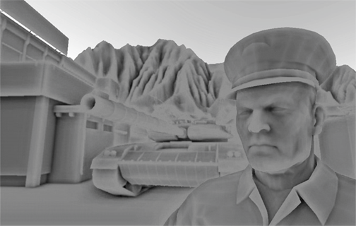

A significant portion of the cost comes from 3D scenes, which influences other aspects of production. It has been around for decades, and a lot of effort was spent to rasterize triangles at maximum performance. Intrinsically, rasterization is only aware of a 3D scene’s setup and does not account for how light travels and interacts in the real world, resulting in accurate but not lifelike quality. To address this, a lot of clever techniques were created to simulate appearance of light effects, each with its own quality/performance tradeoffs, adding overhead to content creation pipelines, development, and testing.
Figure 3. Screen Space Ambient Occlusion.
Finding next gen: CryEngine 2 by Martin Mittring
