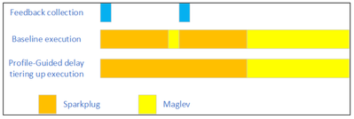

Delay Tiering Up
If a function is deoptimized soon after being tiered up to Maglev, we can assume that its feedback is unstable. This means that the functions need more invocations before tiering up. We record such functions in the profiling runs and assign delayed tiering strategies to them in the subsequent runs. This can avoid the deoptimizations and thus improve the performance.
Screenshot 2025-04-01 at 9.33.05 AM.pngScreenshot 2025-04-01 at 9.33.05 AM.png
Profile-Guided delay tiering up
