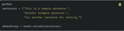

Generating Embeddings
Once you have loaded the model, you can generate embeddings (vectors) for your text data by passing a list of strings to the `model.encode() ` method:
Figure 2: Generate embeddings from the text data
The `embeddings` variable will contain a array with the dense vector representations of your sentences. The number of dimensions depends on the specific model used.
