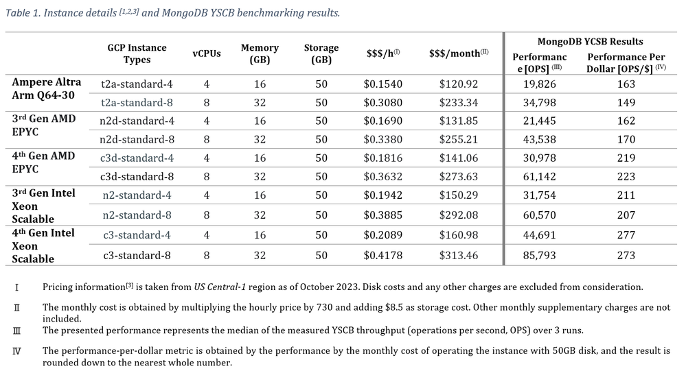

The general-purpose machine family on the Google Cloud Platform was chosen to perform the benchmark. To compare performance and performance-per-dollar across different processors, we opted for the following 5 instances that offer a substantively representative cross-section of the prevailing choices in the general-purpose machine spectrum: t2a-standard (Ampere Altra Arm), n2d-standard (3rd Gen AMD EPYC), c3d-standard (4th Gen AMD EPYC), n2-standard (3rd Gen Intel Xeon Scalable Processor) and c3-standard (4th Gen Intel Xeon Scalable). These machine types were equipped with either 4 or 8 virtual Central Processing Units (vCPUs). The instance details used for testing are shown in Appendix A.
For every scenario, a minimum of three runs were executed. If the outcomes exhibited variations exceeding 3%, an additional measurement was taken to eliminate outlier cases. This approach ensures the accuracy of the final value, which is derived from the median of these three recorded values.
Results
The tests were conducted in October 2023. All results are shown in Appendix A. To present the differences between the individual types of instances more clearly, normalized values were computed in relation to the outcome of the n2-standard instance.

  • C3-standard machine series powered by 4th Gen Intel Xeon Scalable processor offers the highest performance and the most favorable performance-to-cost ratio among the others for performed MongoDB workload.
  • The instance c3‑standard‑4, powered by 4th Gen Intel Xeon Scalable, exhibits a 40% performance increase compared to n2‑standard‑4, which runs on the previous generation of the Intel Xeon Scalable processor. Furthermore, c3‑standard‑4 demonstrates an impressive 2.2-fold performance enhancement over t2a‑standard‑4 and outperforms n2d‑standard‑4 by over 2x.
  • In terms of performance per dollar, c3‑standard‑4 gives you a 30% higher value you get for your money than n2‑standard‑4, despite being $0.0147/hour more expensive.  When contrasting the outcomes of c3‑standard‑4 to the instance with the lowest operating cost in the statement, which is t2a-standard-4, there is a $0,2345/h disparity in cost. Nonetheless, c3‑standard‑4 maintains an 84% performance-per-dollar advantage over t2a‑standard‑4, which makes c3‑standard‑4 a more economically viable option from this perspective.
  • The results obtained for instances with 8 vCPUs consistently position the c3‑standard machine series as the leader in both measured throughput for the MongoDB workload and calculated performance-per-dollar metrics.

Appendix A
