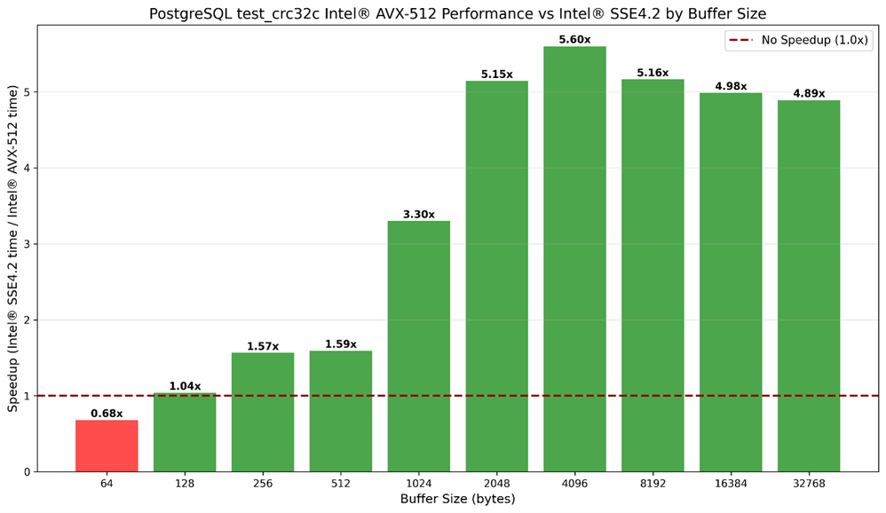

PostgreSQL test_crc32c (Database Integration)
Within PostgreSQL's CRC32C implementation, Intel® AVX-512 provides 1.04x to 5.60x speedup over Intel® SSE4.2 across buffer sizes from 128 bytes to 32KB.

PostgreSQL test_crc32c: Database Integration Results
Within the test_crc32c extension, the drive_crc32c function provides an assessment at the PostgreSQL application level. It allocates a buffer of size num, fills it with random data, and then repeatedly computes the CRC32C checksum on this buffer for count iterations. The final CRC32C value is returned as a bigint. It is installed as an extension in PostgreSQL. The timing was captured via PostgreSQL /timing. For all but the smallest buffer sizes, Intel® AVX-512 is markedly more efficient.
At very large buffer sizes (16384, 32768), Intel AVX-512 maintains substantial performance advantages, achieving a speedup of 4.8x or more.
