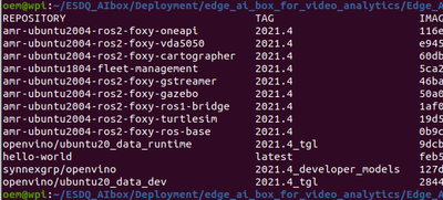

Dear Sir,
We run ESDQ AIbox 1.2 deployment configuration on TGL lake platform that have some fails.
1. On install step, it shown on AWS failed as below (this situation is same as ESDQ vision 6.0):
W: GPG error: https://dnw9lb6lzp2d8.cloudfront.net stable InRelease: The following signatures were invalid: EXPKEYSIG 68D644ABD2327D47 AWS Greengrass Master Key
E: The repository 'https://dnw9lb6lzp2d8.cloudfront.net stable InRelease' is not signed.
2. Latency and Throughput metrics are null in the ESDQ HTML report page. It is look like I need to download yolo-v3-tf.xml for test procedure. Is there have any guideline for how to do?

Hi Lim Xiang Yang,
The report data is available after adding root-permission("-u 0") to Yolov3Tests.sh Line58 as below:
docker run -it -d -u 0 --name $containerName -v /tmp/.X11-unix:/tmp/.X11-unix -e DISPLAY=$DISPLAY -v ~/Downloads:/mnt --device /dev/dri:/dev/dri --group-add=$(stat -c "%g" /dev/dri/render*) --rm $docker_pull_models /bin/bash
The result:
Many thanks for your kindly help!

But for the yolov3, "synnexgrp/openvino:2021.4_developer_models" docker container is already pulling out before test procedure. For throughput test item, where can I find the detail step to generate test data and could I do it manually?

May I know what is the output if you run the following command? Because from the log file provided, it seems like it has an issue copying the yolov3 model file to the directory.
ls -la / | grep mnt

Hi Lim Xiang Yang,
The result:
