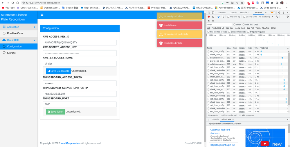

I successfully set up this case on my computer with Ubuntu 20.04 operating system, but when I connected it with AWS EC2, I encountered the following problems,
When I enter the following command to build the webui,
sudo make webui EII_BASE=/home/gvsai/automated_license_plate_recognition/Automated_License_Plate_Recognition_2022.1/IEdgeInsights REPO_FOLDER=/home/gvsai/automated_license_plate_recognition/Automated_License_Plate_Recognition_2022.1/Automated_License_Plate_Recognition/EII-LicensePlateRecognition-UseCase
Immediately the following warning appears:
2022-11-30 16:02:10,291 : WARNING : root : [cloud_manager.py] : in line [51] : Empty keys (aws).
2022-11-30 16:02:10,291 : WARNING : root : [cloud_manager.py] : in line [65] : Wrong credentials: waiting for valid aws credentials.
When I enter the correct access key and the correct s3 bucket on the webui, the error message will appear as shown below,
After I set up ThingsBoard Cloud Data on AWS EC2, when I input the correct access token key on the webui, the error message as shown below,
What is the reason for this problem?

I have an update from the development team. The current release only works for aws instances that create in region us-east-1. Could you try to create an AWS instance in this region? This issue should be addressed in the next release. At this time, I don't have an ETA on the next release.

Thank you for reporting, I am able to reproduce the issue after inputting my correct AWS details.
Let me reach out to the engineering team for additional assistance.

Hi, thank you for your help, we will come back to test after the next version update.
We previously chose to set up AWS EC2 in Oregon.
