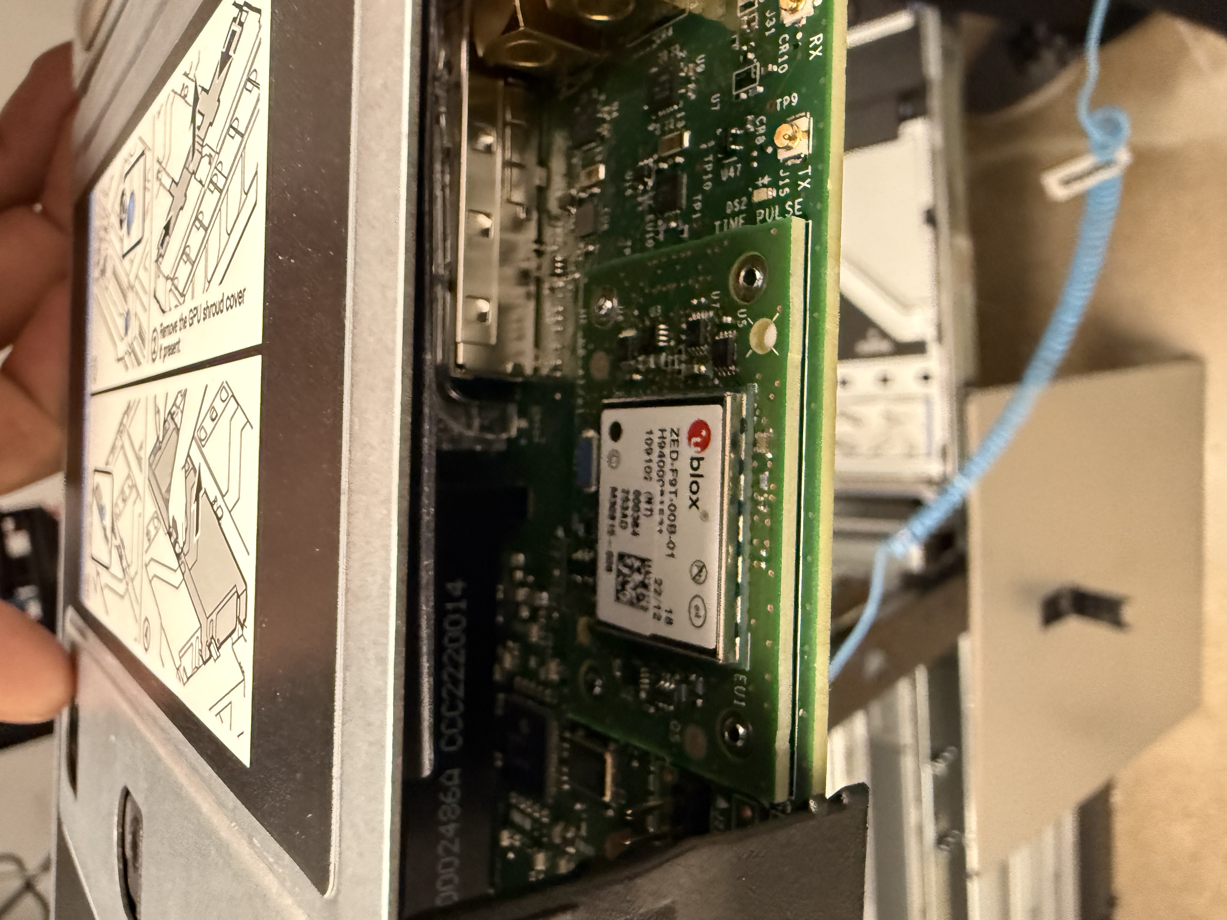

Thank you for contacting Intel. To proceed further with your inquiry, I kindly request you share the below details:
1. Clear front and back pictures of the adapter ensuring the labels are visible.
2. Please confirm whether the adapter was purchased separately or is inbuilt.
3. System on which the adapter is installed.
4. Elaborate the issue that you are facing.

Please find my answers inline below:
- Clear front and back pictures of the adapter ensuring the labels are visible:
→ Attached are the requested images showing both front and back views with visible labels. - Please confirm whether the adapter was purchased separately or is inbuilt:
→ The adapter is an add-on card and not built into the server. - System on which the adapter is installed:
→ Dell PowerEdge R750. - Elaborate the issue that you are facing:
→ We are using GNSS-based synchronization as per the Intel® Ethernet Network Adapter E810-XXVDA4T User Guide (Rev 1.7). DPLL0/1 successfully lock to the GNSS-1PPS input reference. However, when the GPS SMA cable is disconnected from the NIC, the DPLL transitions from "locked" to "holdover" and then unexpectedly switches to "free run" within approximately one minute. According to the Intel guide, the expected holdover duration should be around 4 hours for ±1.5 µs accuracy.
