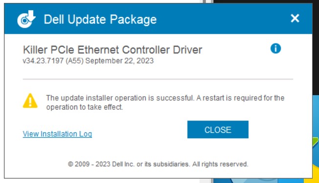

I just followed the steps for the clean installation, in the joint file the last update window before rebooting my computer
But at the restart, i go check the driver, and now it's an old one from 2015 .... I don't know what's going on (also in joint files)
I tried the clean installation again fr both the Killer Performance Suite and the driver, and it's back again at the 1125.24.318.2025 version
When I uninstall the "UWD" it comes back when the new Performance Suite is installed
I really don't know what to do....
