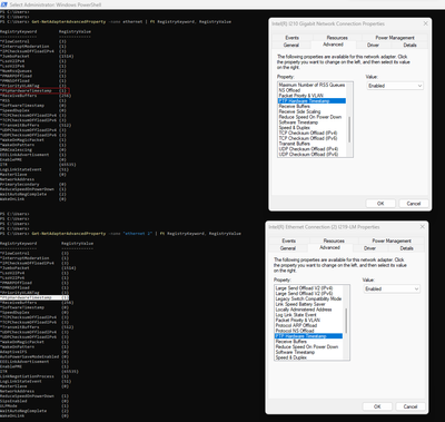

Ossama-MOUSTAFA
New Contributor II
7,234 Views
Hi @Faez_Intel.
Thank you for your answer.
It's not just a problem about PROSet.
We can already "enable" PTP Hardware Timestamp in Windows without using PROSet :
We have problems with intel drivers, it doesn't work if we try to get hardware timestamp in windows.
Best regards.

Hi @Faez_Intel.
Yes, my "PTP Hardware Timestamps" are enabled :
(We can't use "Set-IntelNetAdapterSetting", it comes from intel "Wired PROSet", but this exists just for windows 10,
not windows 11,  and we have to use windows 11 for the Microsoft API. )
Here are my latest SSU logs, as an attachment.
Best regards.
