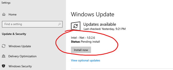

VipeNess
40,716 Views
I also have the Asus ROG STRIX Z490-E GAMING motherboard.  You have to apply the firmware file 1.4.5 from their support website.
https://rog.asus.com/motherboards/rog-strix/rog-strix-z490-e-gaming-model/helpdesk_download/
After, uninstall the current driver then install the 1.0.1.4 driver from ASUS.  This is absolutely gross but it works... kind of.  You won't get disconnects anymore but will still get packet lost.. but not as much.
Note: That Windows update will keep trying to install the new update.
Intel pls fix this once and for all to all current users of this NIC card.

VipeNess
40,606 Views
Here's a screenshot that shows Windows Update and the version number that everyone is talking about which is still messing up their I225-V.  This needs to be fixed and resolved once and for all for the I225-V!
