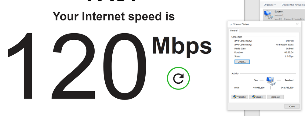

Hi
i am facing issues with my connections speed
i have a router connected via cat6 cable to intel nuc D54250WYK
when changed to 1gbps the lan connectivity is not available nor supported
it works only with 100mbps -(86mbps recived)
just for you to know - i have connected laptop to the same cable - 150 mbps recived .
i have updated bios to the latest ver and the current driver of the i218-v ver is 12.18.9.10.
os is Microsoft Windows 10 Enterprise LTSC (64-bit) build 10.0.17763
please advise

Hi LWAKSMAN
thanks for your comment
i've tried your suggestion as first solution and defined
when defined 1Gbps Full Duplex - the eternet become unavailabe and disconnect with no avilability to reconnect
when defined - Auto Negotiation - it choose 100mbs as defualt

YElul
2,670 Views
Hi
thanks for your support
my adapter speed is set on 100mbps - if autonego or 1gbps is on - no network available
attache my file according to your request

RSwee3
2,670 Views
I have the same issue
Same lan port and same lan cable but different device I get 500Mbs. I have that file you mentioned above but it has a lot of confidential info in there i like IP address I dont want on the net. I have remove as a result.

RSwee3
2,670 Views
yes i would like to know how to get my adapter to work at 1Gps it is quoting? is there a setting i need to change? I should be well able to get 500Mbps on this connection?
I have already ruled out router and lan cable so its 100% something to do with the lanport itself/software
