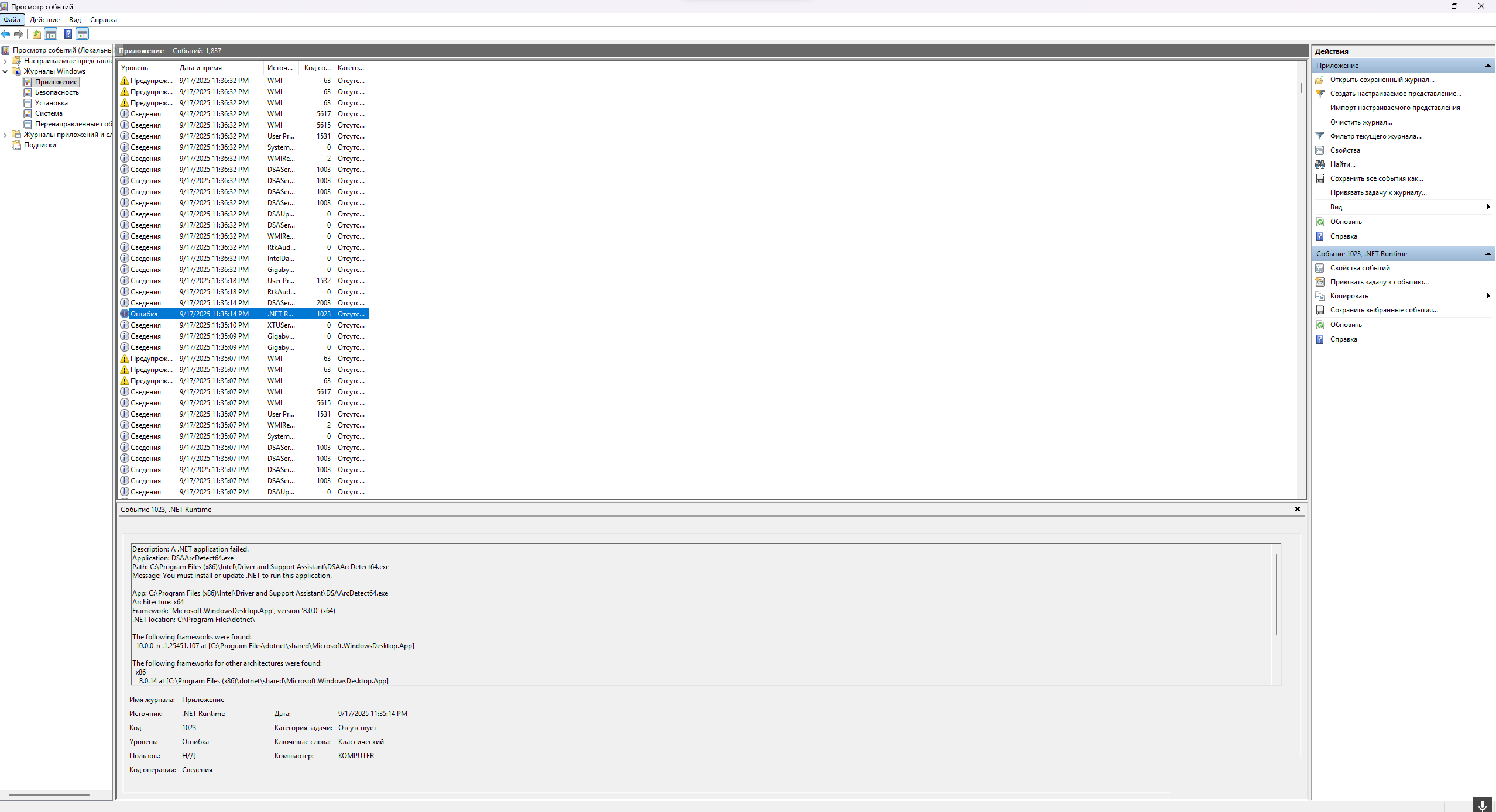

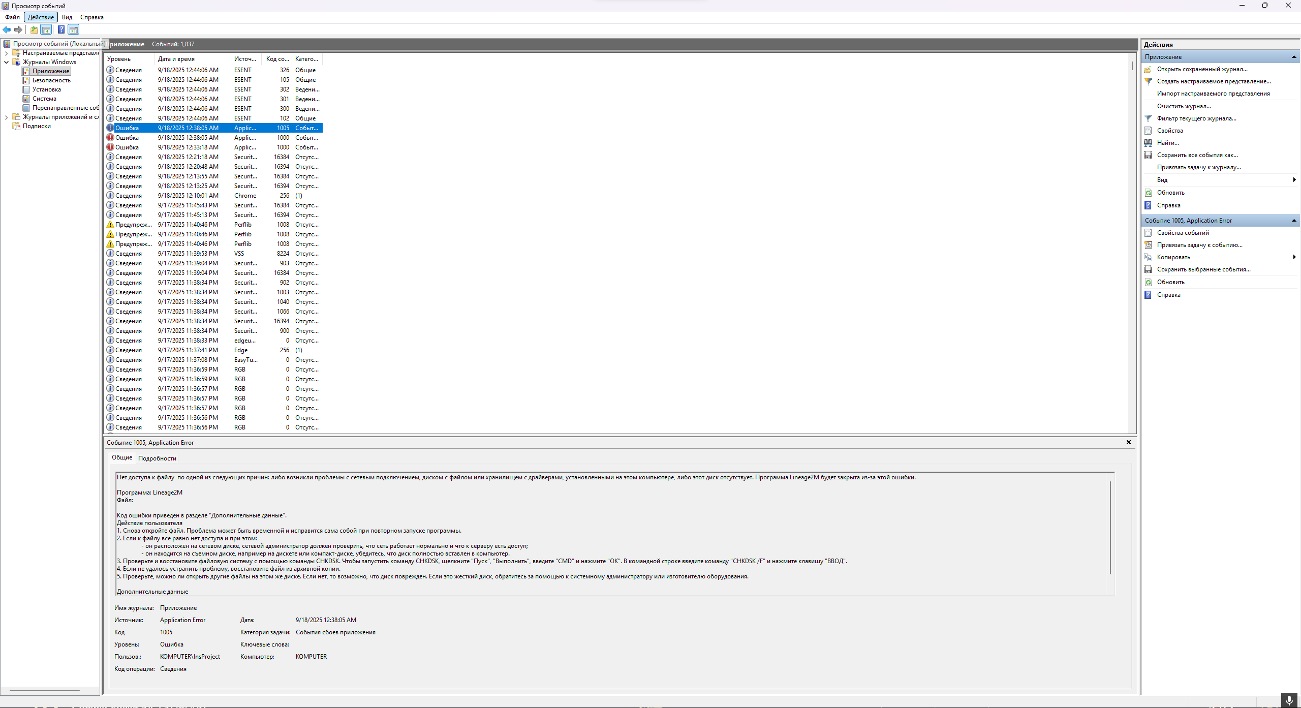

- Games crash after 3–5 minutes with no error or with exceptions (e.g. 0xc0000005).
- Unreal Engine-based games show:
DecompressShader(): Could not decompress shader (GetShaderCompressionFormat=Oodle)
- Event Viewer logs show application crashes with 'unknown' module or nvspucomp64.dll.
- Sometimes Windows logs report: "Out of video memory" errors, but GPU is fine.

...hey dude
all the signs are pointing straight at that 13th/14th Gen Intel issue. You’re getting the same stuff everybody else has been reporting, Unreal Engine and Oodle decompression errors, random crashes, OCCT tripping out, temps shooting past 90°C even on a solid cooler… it’s the exact instability pattern. At this point, it ain’t your RAM, SSD, GPU, or PSU, you already swapped and tested those. It’s the chip. That CPU’s cooked, no two ways about it. Intel already admitted some of these 13th/14th Gen processors got that instability problem baked in, so your i7-14700KF is most likely one of the unlucky ones. What you gotta do now is hit up Intel’s site and open a warranty ticket replacement, That’ll get you a replacement chip. I’m telling you, man, this one in your rig is faulty, no amount of reinstalling or tweaking BIOS is gonna save it. Warranty is the move.
