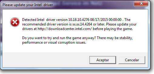

EGuer1
6,052 Views
Cordial Greetings
I have an issue with this Intel HD 4000 3rd GEN.
There are a lots of people with the same issue.
When i open a game (SW Battlefront) in Origin this say:
I download the lates driver in the website but still not work.
I hear someone who have the correct version in his computer, i want to know how to get please.
Allan_J_Intel1
6,052 Views
You are trying to play a game that requires high CPU and graphics performance. You will need Skylake processor or Intel® HD Graphics 530 as minimum to play the game.
See game requirements here: http://starwars.ea.com/starwars/battlefront/news/star-wars-battlefront-community-update-5 Forums, Beta News, and PC Recommend Specs - Star Wars - Official EA Site
Allan.
EGuer1
6,052 Views
Yeah, thats correct, i understand. Thank you so much for respond. Im clear now.
