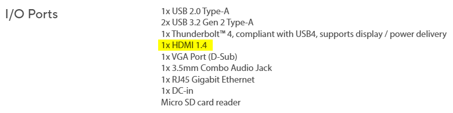

i bought a new laptop a few weeks ago, asus expertbook running 12th Gen Intel(R) Core(TM) i5-1235U. with the default intel iris xe gpu.
the max screen resolution capability is 1920*1080. i have a separate pc monitor PHL 288E2 that can run 4k display, and for some reason i can't seem to change the resolution to a higher resolution than 1920*1080.
I've already tried downloading and installing drivers for the intel iris xe gpu, drivers for the monitor itself. and i've also tried switching between a few HDMI cables (2.0 and above).
the thing is i can see in intel's graphic command center that the device is compatible for 4k display but the wanted 3840*2160 option just doesn't appear in the windows system settings.
please see the attached screenshots from intel's graphic command center.
i would love any advise on how to solve this issue.

As you can see here, the 12th Gen Intel Core U-series processor basically features an HDMI 2.0b interface (18 Gbps bandwidth).
According to ASUS’ specifications, the HDMI port on this particular laptop is only version 1.4 (9 Gbps):
Although this would theoretically also enable 4K, the common reality is that with HDMI 1.4 the resolution is limited to 1080p Full HD. Philips E-line 288E2 monitor also features a DisplayPort connector.
The recommendation would therefore be to connect the monitor via an USB-C/Thunderbolt > DisplayPort cable (example).
If you prefer HDMI to eventually connect the laptop to a 4K TV, I can recommend this solution:
