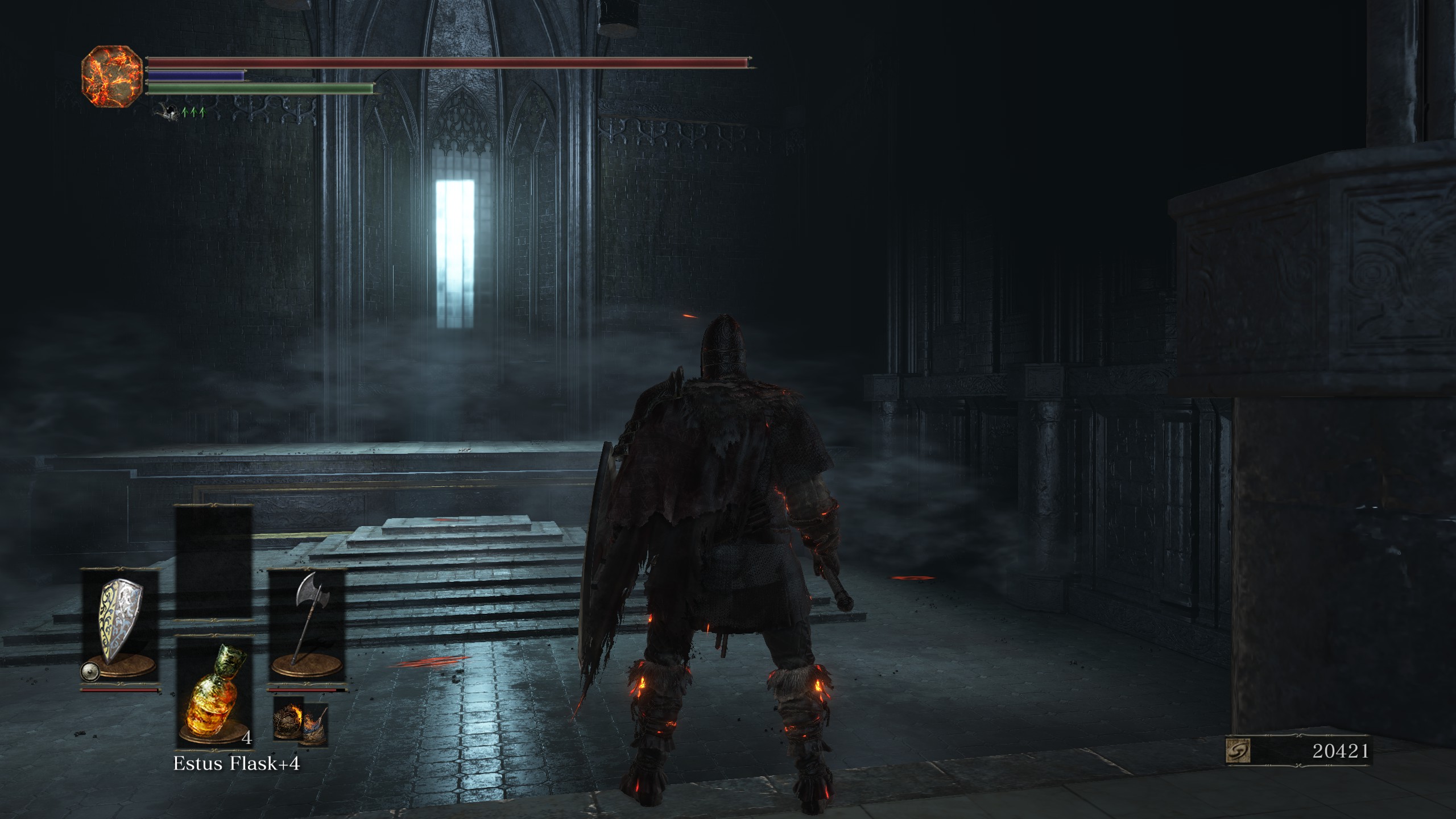

I have the ARC A770 GPU 16 GB edition, with the latest drivers (from early june, WHQL)
In the game dark souls 3, in areas that have windows and light, depending on the camera angle there are graphical corruption and the light on the window is shown in square patches.
I have included screenshots to make it clearer.
I can answer additional questions if needed.

1) Yes, I am using the Intel brand , 16 GB limited edition Arc A770
2) It wasn't working before, last I played this game almost a year ago, it had the same glitches
3) N/A
4) Other than reinstall drivers, and update drivers I have also tried DXVK dlls , and they seem to add some missing light effects that I didn't know existed, but doesn't fix this particular issue
Thank you

I have the latest Bios for my motherboard.
it was quite a bit of hassle but I used DDU and reinstalled the drivers.
It is the same as before.
I believe this is a drivers issue, as using dxvk dlls adds some additional effects such as light or flame that were missing and I didn't even know, which for me shows that it's more of an intel driver issue.
Technically the base drivers are missing some other effects on dark souls 3 that I wasn't aware of before trying dxvk.
Thank you.

1) You can find a SL120 save file on nexus mods, it would be much easier to download from there than to share my save file, that might have identifying information. Here is the link https://www.nexusmods.com/darksouls3/mods/203
2) If you have a sl120 save file, you can teleport to any bonefire.
- It is visible in the area with the windows and knights , upstairs, then right, from the Distant Manor Bonefire . You start from distant manor bonefire, go upstairs, and follow the lake to the right in the cave, then to the end of the cave you have another staricase on the right, follow that and you will find this zone after you traverse this room. But there are enemies here, but with a sl120 and a fire weapon they should pose no problem. or you can try to sprint through the enemies.
- Or a safer area with no enemies is the DarkMoon Tomb. To get there start from the  Anor Londo bonefire then go down on the staircase (turn the lever on) then you have a invisible wall you have to attack. This area might be the easiest to access as there are no enemies there.
Here is a video on how to get there , look rather from about 1 minute in, the start of the video is another area.  Start from the Anor Londo bonefire, and behind you there is a staircase, you have to pull the lever if it's not up, and in the staircase turn a lever to get it down.
https://www.youtube.com/watch?v=ZanwhyVEb_U
3) This issue happens in areas with certain windows types and light coming through them, or some areas with flames such as candles or on some enemies.
I have noticed it in multiple areas (see previous post) but not at the start of the game, as there are no such windows to my knowledge at the very start of the game.
Hope this new information is useful and can help you diagnose it.

I wanted to inform you that we have successfully replicated the issue you reported, and we will be forwarding this information to our development team.
We are committed to keeping you updated and will provide further information in this thread as soon as we have more details from our investigation.
