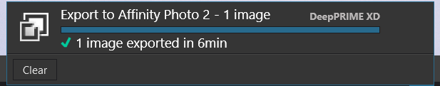

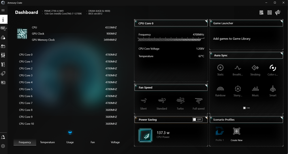

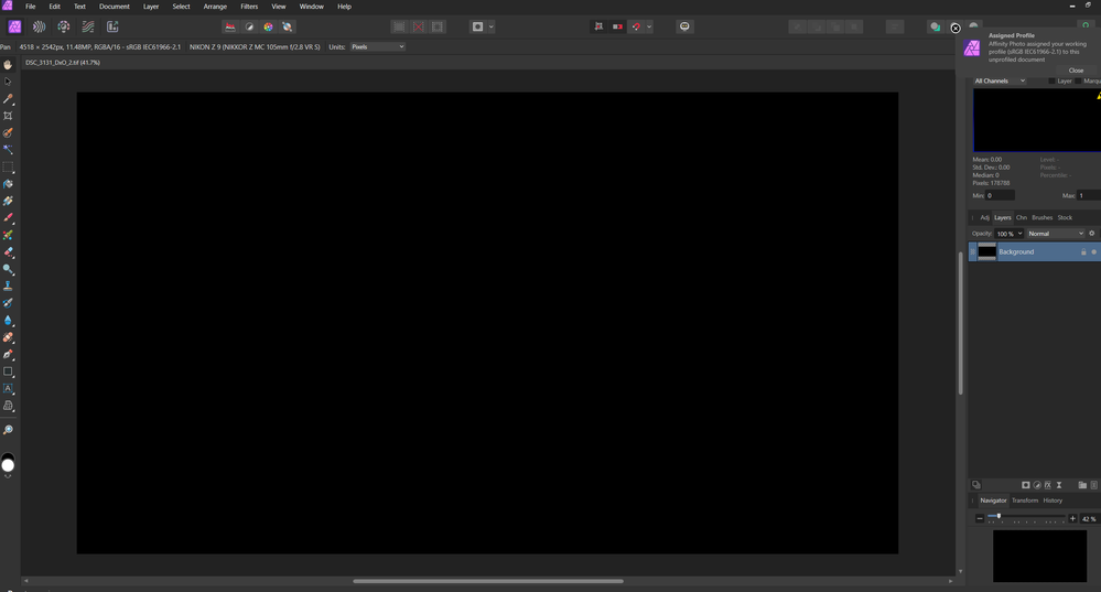

Update on my last post. I posted this in the DXO support page. Hope this helps out both driver teams at Intel and DXO.
As you can see the CPU is running at full throttle all 12 cores being utilized to their max and are burning up, reason is the Intel GPU is not being utilized as it should be, matter of fact it's not being utilized at all, it might as well not be installed on the motherboard. The ram 64 GB DDR5 4800mhz is also running hot.
First screenshot with PC in normal mode. Second screenshot with DXO processing the RAW file using only the CPU "the GPU can not be used". Third screenshot is the Performance/Preferences window, it says that unsupported GPU's will automatically be disabled "looks like both the Intel ARC 770 and the UHD 770 are not supported, which makes no sense", the enable OpenCL box is grayed out. Fourth screenshot is the time it takes for the RAW file to be processed, some take longer than others depending on the data in the file, as you can see it took six minutes for the file to be uploaded to AF2 as a TIFF, which should take between 40-60 seconds max if the GPU was able to be utilized. Once in Affinity Photo2 "fifth screenshot" the Intel ARC 770 or the UHD 770 both work as they should.
The last screenshot is what the file looks like when trying to use the GPU in DXOPhotolab6 after it is exported to AF2. As you can see it's just a black box, all the data missing, since DXOPhotolab6 is not recognizing the Intel GPU/GPUs.
Hope this helps out, and gets resolved as soon as possible. I will also furnish all this information to Intel in their Intel forums support page.
I don't care how wonderful the specs are regarding the hardware, regardless of industry, if the software is dodgy, or lacking, it will literally destroy your product. And with that your reputation, and with that, that product line. Especially if the hardware has been on the market for a year plus, give or take. Intel, are you listening.
CPU running at idle
CPU running like a banshee trying to process the file

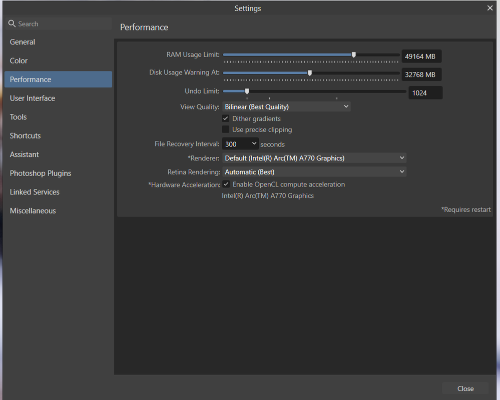

DXO Performance panel shows the the Intel GPUs are not supported, which makes no sense
The time it took for the TIFF file to be exported to AFP2, which should take less than one minute if the GPU was utilized, which also would cause less strain on the CPU
AFP2 Performance panel shows that both the Intel GPUs work and are supported
This is what it looks like trying to export from DXO to Affinity Photo 2 using the GPU, all the data is missing. Since the Software does not recognize the GPU.
