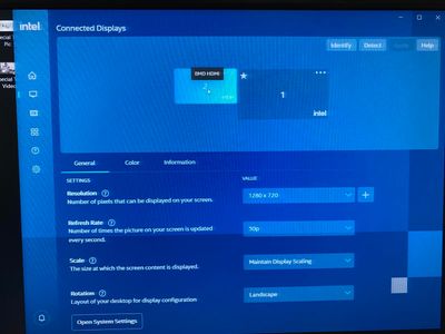

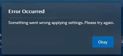

This has been a problem for years. I still don't understand the rationale behind it, but here we go:
You can select a resolution of 1280x720 for your second display connected to your integrated Intel UHD Graphics 730. And we need this 720p resolution for our HDMI-SDI switch and the Roland mixer behind it. But the Roland mixer shows an error message. Why?
If you go (in Windows 10) to Display > Advanced display settings > Choose display you see under Display information the "Desktop resolution 1280x720" but below as "Active signal resolution 1920x1080". Which is not a 720p signal our Roland mixer is expecting, when I change the resolution in Windows to 720p.

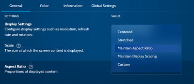

In the old Intel Graphics Control Center there was a setting called "Maintain Display Scaling" but this setting does not exist in the new Intel Arc Control:
As you can see, there is a "scale" option, and you can select "Maintain Display Scaling". Which means that, if you select a 720p signal output, you get a 720p signal output. Currently I'm working for over an hour already, and can't find a solution that worked in April 2022 with the old driver. It would be great to get this setting back! I don't need a 1080p signal that has a 720p signal somehow embedded. Maybe someone thinks that the upscaler of the graphics is better than in my monitor, but please let me do this decision. Please let me have a720p output when I select one.
One final little request: Please refrain from answering to this question in a manner of "Hello, welcome to our forum ... I'm here to help ... have you submitted this request with our special software ... please install this and then ask your question there ... can you give me the version of your driver ... have you updated your driver ... have you updated Windows? ... can you check the HDMI cable ... have you tried switching it on and off again ... please submit a log file" or whatever. If you don't understand the problem, requesting all these information does not help you to understand it better. If you do - you would not ask these questions.
In January 2024 the option was still available: https://www.intel.com/content/www/us/en/support/articles/000057700/graphics.html

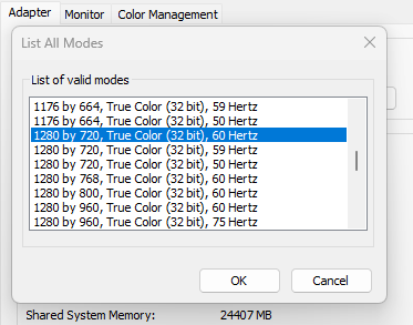

I have also encountered discrepancies between "Desktop resolution" and "Active signal resolution" that I could not explain. Often, this could be resolved by:
  • Select Start > Settings > System > Display
  • There’s a link labeled Advanced display settings. This takes you to a second page where you can view the attributes for each monitor. At the top is a drop-down menu listing your displays. Choose the one you want to check if you are using more than one display. Then you can see "Desktop Mode/Resolution" and "Active Signal Mode/Resolution". If they differ proceed as follows:

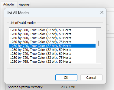

    • Click the Display adapter properties link.
    • The system will open a window with your GPU properties from the classic Control Panel. Click the List All Modes button.
    • Select desired resolution in the next dialog. Note that Windows lists a single resolution several times with different refresh rates. Make sure you pick the right one.
    • Click OK to save your changes.
    • Click OK to leave the property window.
      NOTE: If changes don’t take effect, then it may be useful to repeat the steps above using another resolution and then again repeat the steps reverting back to your desired one to “synchronize” the Desktop Mode with the Active Signal Mode.

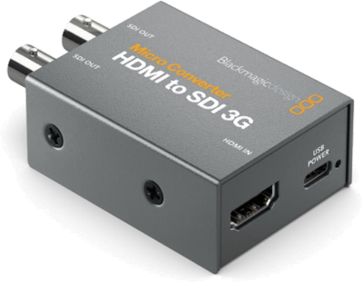

  3. Which switch is being used here? From your screenshot, I can see that the device is reporting in the Extended Display Identification Data (EDID) over the HDMI cable via Display Data Channel (DDC) that this is a BlackmagicDesign (BMD) product. Is that correct?
  4. Which HDMI cable do you use? Manufacturer, model and length?
  5. To analyze the EDID that the PC receives, please create a Report for Intel Graphics Drivers on the PC and attach the output file here.
  6. Roland Corporation makes a variety of audio/video mixing devices. Which one are you using? It appears to have a Serial Digital Interface (SDI) input. Is the monitor also integrated here or are you using another monitor that is embedded in this signal chain elsewhere? Please describe the signal chain in all details, preferably with a sketch.

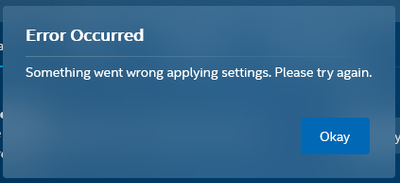

And I wanted to add that it does not work and does not change the "Active Signal Mode/Resolution". I switched back to the Intel Arc Control, clicked on Reset to Default, then back to Advanced display settings and changing to the desired mode. At one point both resolutions in "Active Signal Mode/Resolution" and "Desktop Mode/Resolution" aligned to 1280x720 - finally! But the Roland mixer was still not processing the signal. I realized that the refresh rate was set to 60 Hz, but we need 50 Hz (AC frequency here in Vietnam). After switching to 50 Hz the Active Signal Mode switched back to 1920x1080. Wrong Active Signal Mode again ...
It took about 30 minutes to reset, apply, change, back to "List all Modes", select another one, change refresh rate, and confirm that finally the resolution aligned, and the output was 50 Hz. I was able to use the Roland again! 😊 Exactly as MUC wrote above in the Note after the instructions. I was happy! Here a few details:

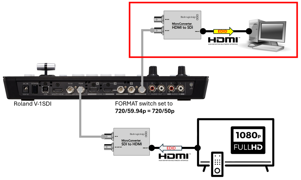

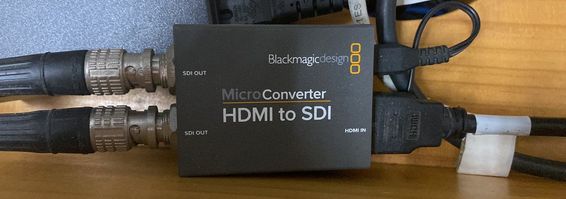

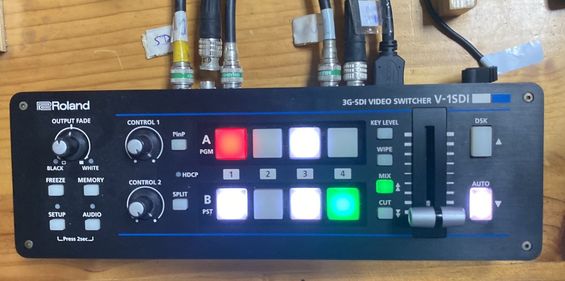

A) The Setup
I think our very specific setup is rarely found, and the problems described here relate only to a few cases. General setups are much simpler and should work in almost all cases (see B later). Here is a simplified signal chain with the cable type in [brackets]:
PC: ---[HDMI]--- :Converter HDMI-SDI: ---[SDI]--- :Roland mixer: ---[SDI]--- :Converter SDI-HDMI: ---[HDMI]--- :FullHD TV
And MUC is right, the Converter are both from Blackmagic Design, and the picture he used is right, too! This whole chain has 4 cables and 5 elements. All of them are capable of 720p and 1080p with 50Hz and 60 Hz, detect it automatically and work - except the Roland mixer, which only operates at 720p at 50Hz. The Roland mixer has a manual switch on the side to change to 1080i or 1080p, but two camera input signals are 720p 50Hz SDI, so that is the mode we operate in.
The apparent problem or challenge of our setup is that the PC determines its output signal by communicating with the Blackmagic Design converter (as mentioned above by @MUC  over the Extended Display Identification Data (EDID) over the HDMI cable via Display Data Channel (DDC)) and therefore assumes that it can output a 1080p signal without problems. The PC can't see further down the chain, and in most cases this would already be the monitor or TV. For almost all use cases that's the best solution, so the Intel driver defaults to this setting.

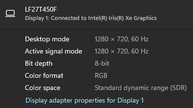

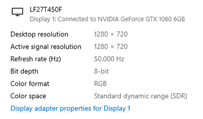

Currently I have a different test system here with a HP Elitedesk 800 TWR G4 i7-8700 (thanks MUC for some background information why just the CPU or GPU might not be sufficient to narrow down possible error sources) running Windows 11 Pro and one monitor connected over DVI, a second one over HDMI. And I discovered that the intel Graphics Command Center still exists and can be downloaded from the Windows store. I currently have version 1.100.5688.0 which is newer than 1.100.2765.0 I referenced in my original post. According to this post on uptodown.com it is from November 11, 2024. And the option "Maintain Display Scaling" is still there!
So I tried 720p on my second display (Samsung LF27T450F FullHD) and got the expected:
Now switching to "Maintain Display Scaling":
What about System > Display > Advanced display and "Display adapter properties for Display 2" followed by "List all modes"? I have 1280x720 with 3 refresh rates available:
None changes the Active signal mode. I'll investigate further and will update here. Now just shortly answers to the 6 questions:

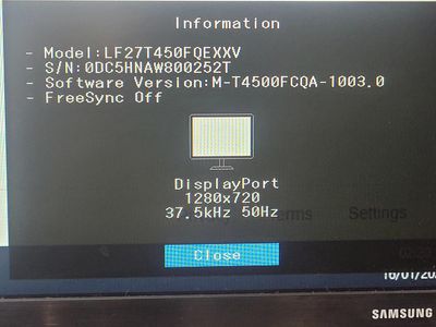

Matthias_Saigon
21,929 Views
The above post was done yesterday evening, and confirmed - but somehow lost on the Intel server. It's partially restored, and some edits were made afterwards, but they await moderator approval. In the meantime I did some further testing:
I switched monitors, cables, ports (DVI and HDMI) on both PC and monitor, and got the same result.
My testing indicates an issue with the driver API, since the hardware is able to generate the native 720p/50 signal and has done so with all drivers since 2022. The different drivers should in general be able to tell the GPU to generate a 720p/50 signal since they have done so since 2022, even after a fresh installation of Windows 10 Pro (from a previous Windows 10 Home or LTSC) and several Intel Arc Control updates. Somehow I got it working yesterday again, but it was more a try-and-error approach. The Intel Arc Control does not have the "Maintain Display Scaling" setting, and in my test setup from yesterday this setting exists in the Intel Graphics Command Center but produces an error and does not work (all other 4 options work as intended).

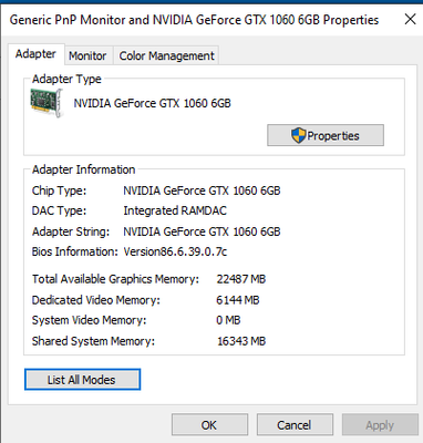

For comparison I tried a different graphics card manufacturer, and went with a broken Nvidia GTX 1060 (only two DVI ports create an output) on Windows 10 22H2. In standard setting you get the same difference between  "Active Signal Mode/Resolution" and "Desktop Mode/Resolution". But you can use both the NVIDIA Control panel and  the Start > Settings > System > Display > Advanced display settings > Display adapter properties > List All Modes path to change the Active Signal Mode/Resolution. With every single one of them is correctly applied right after pressing the button:
The system has a second GPU, an older GTX 960, connected with just one PCIe lane from a riser card, and limited to PCIe 1.0 speed in the BIOS. And again, with both paths of adjusting it (Nvidia panel and "List all modes") the settings were adjusted to the desired 720p/50. Surprisingly even 4K worked, but that's another topic.
This indicates, as mentioned above, that the problem seems to be how the Intel driver receives the settings from the IGCC or "List all modes" and adjusts its settings. Currently IGCC causes an error, and "List all modes" is ignored in most cases.

  • Intel Graphics Command Center 1.100.5688.0 Display > Connected Displays > General > Scale > Maintain Display Scaling causes an error (the 4 other options Centered, Streched, Maintain Aspect Ration and Custom work as intended):
My take is that the communication from IGCC or the Windows Advanced Display settings to the driver is broken from the Intel UHD driver side. It worked in 2022, but is currently not working with IGCC. And sometimes it works with the Windows settings (see the Note by @MUC ).

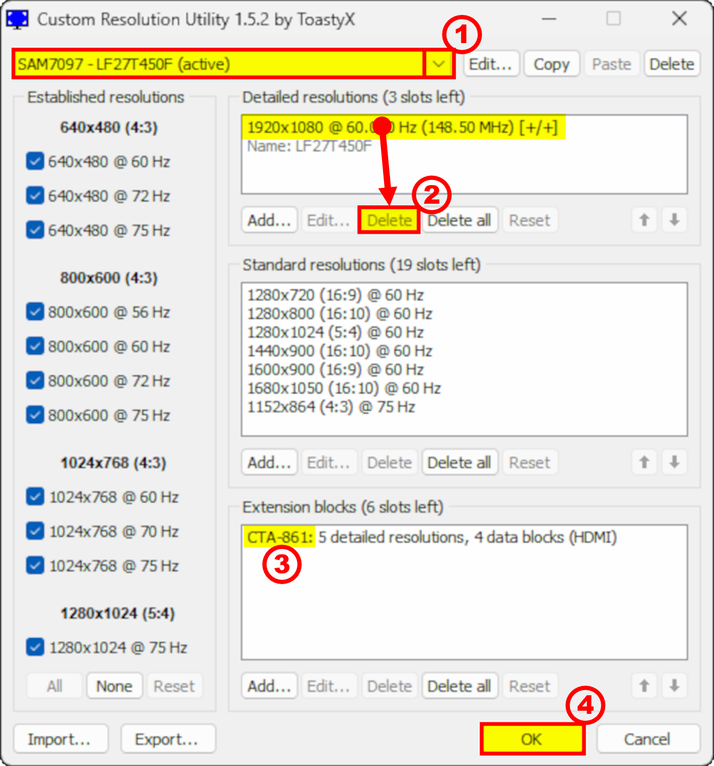

The EDID of a sink device is read when connected to the PC and saved in the Windows registry. It can also be changed there (EDID Override).
I can reproduce the described behavior using the EDID of the Samsung LF27T450F from the diagnostic report on my system. The resolution modes are listed multiple times in the EDID, so the EDID seems to be somehow "over-determined". I cannot explain why other graphics drivers can handle this but the Intel drivers obviously have issues here. However, you can influence the behavior with a tool per EDID Override. The easiest way to do this is as follows:
  • Download Custom Resolution Utility (CRU)
  • Run CRU.exe
  • Make sure the active EDID is LF27T450F connected to your PC. If necessary, select from the drop down menu (1).
  • Delete the Detailed Timing Descriptor (DTD) above (2). This is no problem since the same resolution and refresh rate with the same timing parameters is also defined within the CTA-861 Extension Block (3).
  • Please close CRU with OK and restart the computer.
Note:
All changes made with CRU can be undone if necessary by running "reset-all.exe" from the CRU download package and restarting the system. You can find more information about this tool on the linked page.
Now you can change the resolution to 1280 x 720 using the Windows display settings, whereby the active signal mode initially remains as it was. But now you should be able to adjust this using the "List All Modes" method. First set 50 Hz there, for example, and then return to 60 Hz. Now desktop mode and active signal mode should match.
You can play around with the tool as much as you like. Nothing can break. Once done, this procedure maintains active permanently for a specific computer-to-screen combination.
To return to the original state, run "reset-all.exe" and restart the device. The original EDID will then be read again via the HDMI cable.

Thanks @MUC for this deep dive into the communication between monitor and GPU! This opens a brand new rabbit hole, I just wanted to have the Roland mixer working 😁
The solution with the CRU by ToastyX has a long history. The forum post is from 2012, and the copyright info in the source code with the GPL3 also states 2012. Which indicates that similar problems exist for an even longer time to finally motivate a hobbyist to take on the challenge of fixing things.
Currently I will probably not touch our settings (never change a running system). But for the next time around I will change the EDID entries for the Blackmagic Design converter, so that 720p/50 is automatically selected. And since I can't edit my older post anymore, here is finally the image: 
The BMD converter is just doing it's job, and can easily handle 1080p. But one step further down the chain is the Roland mixer that operates with only one resolution at a time, and we selected 720p with the switch on the right side:
Another option is to add and use a cheap Nvidia or AMD graphics card. My limited testing with both brands showed that both adjust the Active signal mode/resolution when selecting from the "List all modes". Intel is the outlier.
I'll open a new ticket suggesting to fix the Intel graphics driver. But since the drivers seem to ignore the "List all modes" override for at least 10 years, as my test indicates, there might be a reason why this behavior was chosen and is now the standard for all the million devices using the integrated graphics. While I now understand the reason to have the upscaling to the native resolution being done on the GPU, I can't find a reason why it would be better to ignore the user selection of a resolution/refresh rate from the "List all modes" and stick with the interpolated one. Nvidia and AMD are not doing it. Yet given the large user base Intel might be hesitant to change this "well established" behavior, even if it makes not much sense.
A desirable fix even for Intel would be that the "Maintain Display Scaling" in IGCC starts to work again. As shown above it currently causes an error message in all my test scenarios. It worked in 2022. Another option would be to add a working button like this to the Intel Arc Control. I've seen the push (or popup recommendations) for this software in Windows on PCs with just integrated graphics not from the ARC line.

To summarize your configuration:
Since the Serial Digital Interface (SDI) works without EDID to transmit video data, the questionable behavior of the Intel drivers only depends on what happens in the top right area, i.e. what EDID the graphics driver receives and how it processes it. Based on the countless PCs you have tested and what I saw yesterday during my EDID testing, I share your conclusions.
When processing the created ticket, the Intel graphics team should investigate why the "Maintain Display Scaling" option does not work and the GPU forces scaling in any case when 1080p is advertised as the native mode via EDID. This does not seem to be the case with 4K. I can also confirm this observation. An option as summarized in the thread title would actually help here to set the active signal mode correctly.
