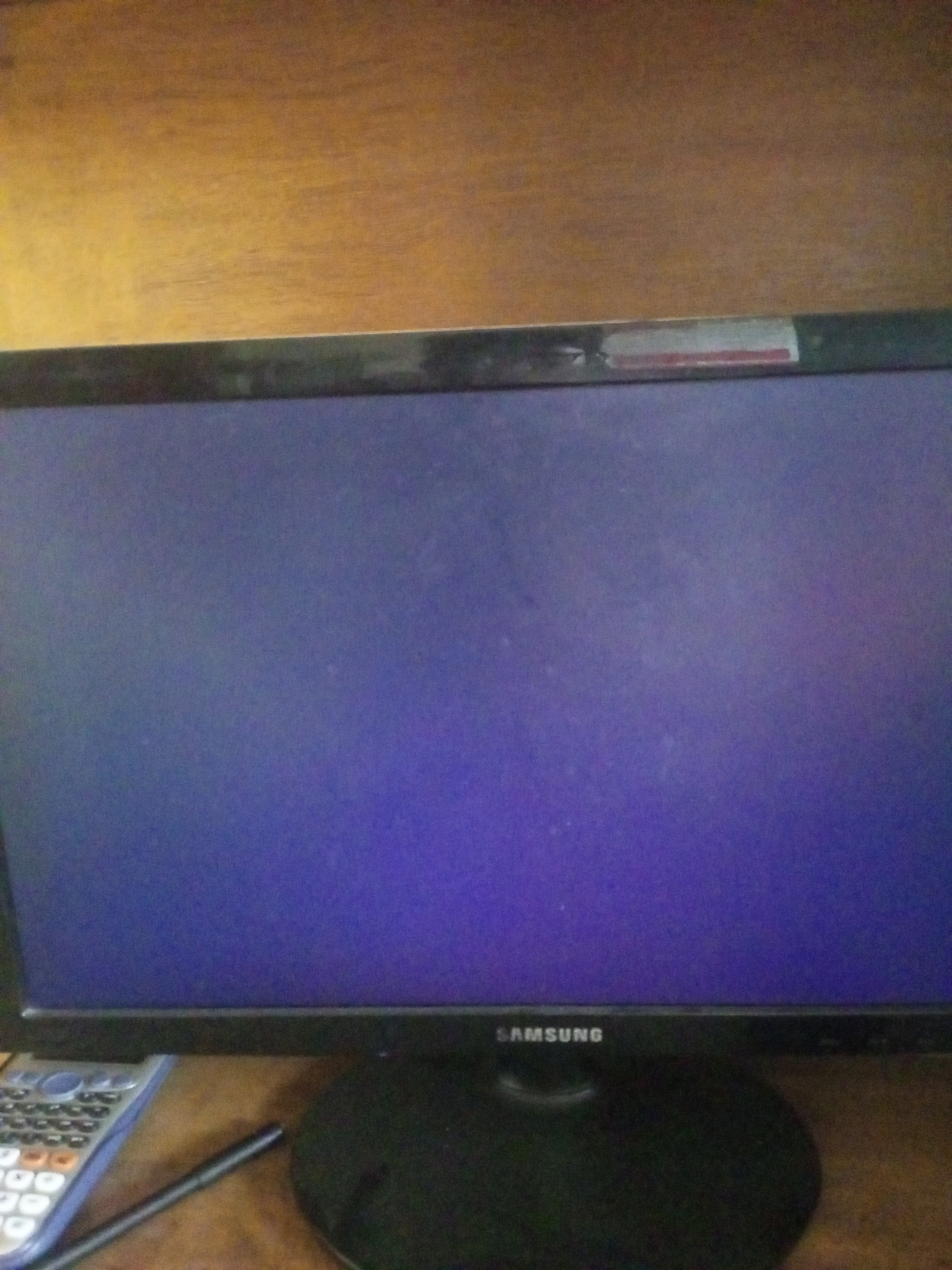

I have been dealing with this problem for months, I thought it will get fixed with new drivers but after months it's still not fixed.
The problem,
When booting my pc, my monitor display a black screen.. I have to unplug and replug my monitor cable to make it display.  It happens every time I try to boot. With my igpu I have no problem when booting.
Am using an old monitor, it only support VGA. Am using a HDMI to VGA adapter to run the monitor.
Driver: 31.0.101.5186
CPU: 12100
GPU: Arc A750 limited edition

Latest build is 31.0.101.5333. I suggest you try again after upgrading.
Thst said, I would also say that dongles like this are problematic.

Done! Running the lastest drive with clean installation with DDU.
Still didn't solved the problem.

Here's the black screen when booting.
