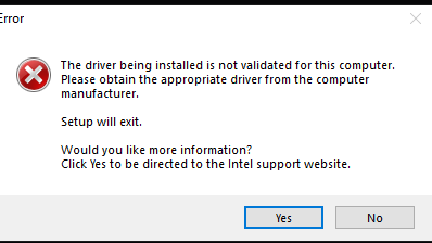

Im trying to run a game called wolfenstein 2 and i need to do a driver update for the "Vulkan error vkCreateDevice : VK_ERROR_EXTENSION_NOT_PRESENT" im getting and i dont seem to find any updated drivers for it and if there isnt any is my only option to change my cpu cuz its integrated
and im using "Version20.19.15.5166" in "Intel® Core™ i3-5010U CPU @ 2.10GHz"
Any link or help abt the update please?
The final driver release for your processor is v15.40.48.5171, which you can download here: https://www.intel.com/content/www/us/en/download/18369/intel-graphics-driver-for-windows-15-40.html. I suggest that you give it a try. If your attempt to install it fails, manually uninstall your existing driver, reboot and then try installing this driver again.
Hope this helps,
apparently it says that
and it appears in 5th generation drivers this happens and clean installation is reqiured but this IS the clean installation the guide had
