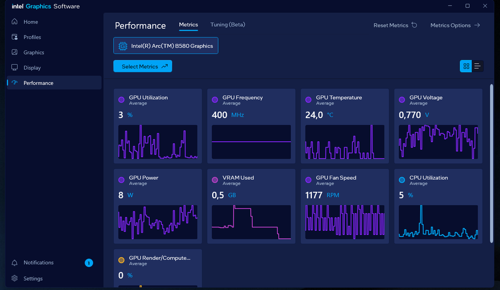

JohnM_Intel
20,439 Views
Hello MrCell,
I want to set clear expectations by stating that the ideal solution is for each GPU vendor to align their fan table and minimum PWM settings to ensure they do not target values lower than the designated Min PWM. In the meantime, to prevent this issue, please set the fan curve to 30% or higher in the fan control settings within Intel Graphics Software.
Additionally, I have sent you a personal email as I have created a case ticket for this thread.
John Sergio M.
MrCell
20,431 Views
Have now set the fan curve too 30% all the way.
High RPM and jumps a lot.
