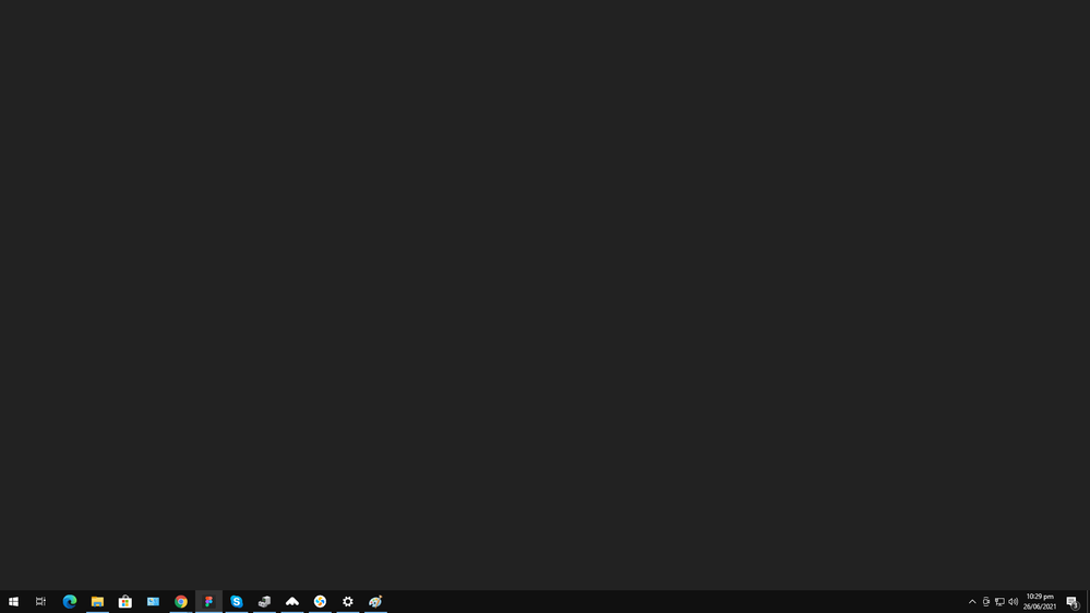

There are alot of glitches using figma on Intel UHD 730. I have attached one of the screens. It goes all black as soon as I open up any heavy document or zoom in zoom out. I have to close and reopen and it loops the same again and again.
Tried versions of drivers with no solutions at all
30.0.100.9667
27.20.100.9616
27.20.100.9613
If I uninstall the driver and use microsoft basic display driver, it works fine. A little laggy but never crashes.

Not even working through browser. Exact same issues and glitches. All grey screen with big black squared mouse cursor.

Okay will follow your guide for Intel System Support. For now what I have discovered is that it's a WebGL error, see attached.
I am getting this error on intel hd 730 only. It works perfectly fine on my 4th gen (HP Laptop - Intel HD), 6th gen (PC - Intel HD) and 8th gen (PC - dGPU).
When I disable the driver from Device Manager the figma works fine, a little slow/laggy but never crashes. But when I enable the driver back it starts to give me those grey screens.
Please review the attached screenshot for the error. After this error the grey screen comes up as attached in my initial post.
I have got the clearance from figma support as its working fine on all other systems/pc. Even I tried dedicated GPU on this PC and it works fine on that. The error is just on i5 11400 Intel HD.
