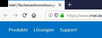

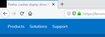

Hi @APMichael​  Nope! 7000 driver didn't fix bug for me, but now its even worse! I get black square on top left corner, if hardware acceleration turn on!
ON2019-08-02 22_26_07-Firefox crashes display driver 6912. - Intel® Community Forum.jpg
OFF
2019-08-02 22_27_03-Firefox crashes display driver 6912. - Intel® Community Forum.jpg

Thanks for the information. I can confirm that the latest .7000 driver is even worse. I also have the black square now...

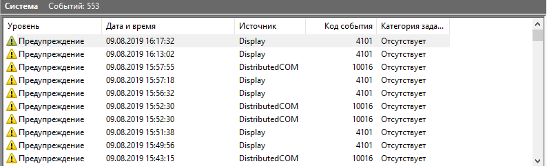

Parapele
6,982 Views
I did everything, Windows 1903 (18362.30) it automatically installed all drivers, for GPU it was 6373.
Results
CanvasMark 2013 Edge pass Firefox 68.0.1 pass (webvizbench not tested)
I only instaled 7000 driver for GPU
Get black box on UI
Edge crashing on both websites, Firefox 68.0.1 crashing on both websites
I did not instal anything except 7000 driver, and Firefox.
It was fun. (not)
