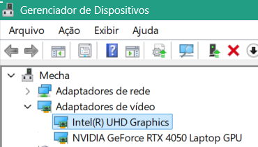

Hi. I have an acer nitro v15, ANV15-51-7037 for almost a year now, and for almost 2 weeks now my notebook started glitching like crazy and having stutterings. But when I'm playing a game, it works normally, without glitches os stuttering. I figured out that when i go to device manager and change the video adapter from Intel(R) UHD Graphics to Microsoft Basic Display Adapter, it works fine. It gets a little slow, but no glitches or stuttering. I asked on reddit and someone said it could be a dying GPU. What can i do?

Next, why are you not using your nvidia adapter?

I don't really know how to use nvidia adpater, i thought it should be using both, as it says .
