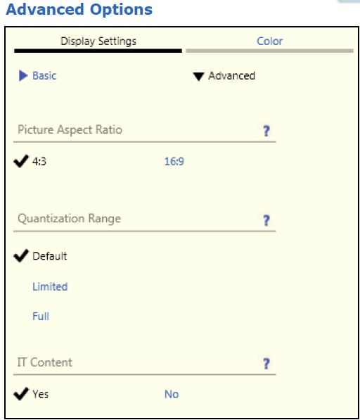

How to manually set video output range to full (0 to 255 color space) like we do in Nvidia Cards
JBlac11
3,656 Views
I saw in the intel control panel there is something called input rage (limited or full) is that the setting i should use ... I thout there would be a setting to make output to 0 to 255 for video playback. In my machine with nvidia card its so easy to toggle to 0 to 255 in Nvidia control Panel.
My machine : HP Probook 450 G1
Card : Intel HD graphics 4600.

These settings can be found on the advance settings in the Intel HD Graphics control Panel.
The Advanced options are available only when the HD display is connected to the system, by using an HDMI cable.
Please go to Display settings > Advanced > enables "Quantization Range" to "Full"

Video output range for Video page can be set in the following way:.
Go to Video>Basic>Input range>Driver Settings> Full
Similarly Display Output range can be set through :
Display Settings>Advanced> Quantization Range>Full.
Let me know if it you need more details.
