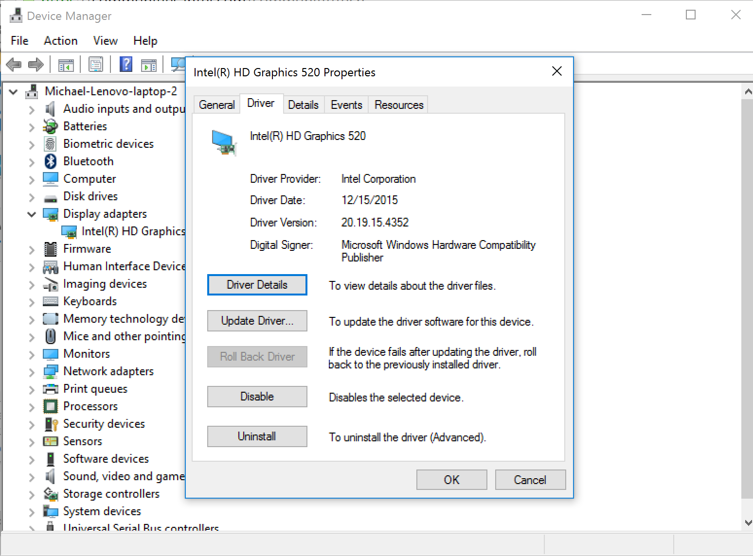

The driver version can be found in the device manager, my apologies for not including this in my previous answer.
Right click in the start button, select device manager, look for display adapters, right click on properties and go to driver tab.
I would like you to test the behavior of your system with the graphics drivers provided by your OEM, here you can find them:http://support.lenovo.com/us/en/products/Laptops-and-netbooks/ThinkPad-X-Series-laptops/ThinkPad-X1-Yoga-Type-20FQ-20FR?linkTrack=GPS:Body_Search%20Products&beta=false Laptops :: ThinkPad X Series laptops :: X1 Yoga (Type 20FQ, 20FR) Laptop (ThinkPad) - Lenovo Support (US)
Please go to pick a component and select "Display and Video Graphics".

Esteban,
I loaded the driver provided by the OEM (see attached image), and continued to have the problem. I then saw a message posed by one of your Intel colleagues, indicating that a new beta driver had been released to address this problem. I loaded this driver (Beta 15.40.20.4404), and, unfortunately, continue to have the problem. In fact, if anything, I would say I am having the problem more frequently with the new driver. In response to one of your previous questions, I have had the problem primarily when using Corel WordPerfect, and to a lesser extent when using Adobe Acrobat Reader DC. I spend most of my time on the machine using these two programs so it is possible that it is just statistically more likely that this is where the problem would manifest.
