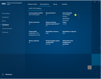

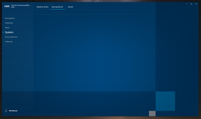

Intel commands center not showing UHD 750 card name and details. Tried all drivers 9127, 9805 and latest beta 9862.
On other PC with UHD 630 is ok

  • When did this start? - Always since I've bought new motherboard and cpu this July

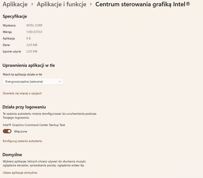

  • Which version of Intel® GCC do you use? GCC using from Microsoft Store (latest I think 1.100.3370.0)
  • Do you use the BETA version? Tried Beta and official - no differences
  • Did you make any recent updates or hardware changes on your system? - yes (changed motherboard and cpu but Windows is clean and it doesn't matter if I will install Windows 10 21H1 or Windows 11 latest beta build - for today is 22000.176)
  • Do you get the same problem after reinstalling the software? - yes
    I tried drivers 9127 (default from Windows Update) and latest 9862. Still no details about card.

Unfortunately any of above recommendations not working.
Tried OEM driver and latest 9894 and doesn't matter if Windows 10 or Windows 11 is installed, still no info about integrated UHD 750 graphic card.
